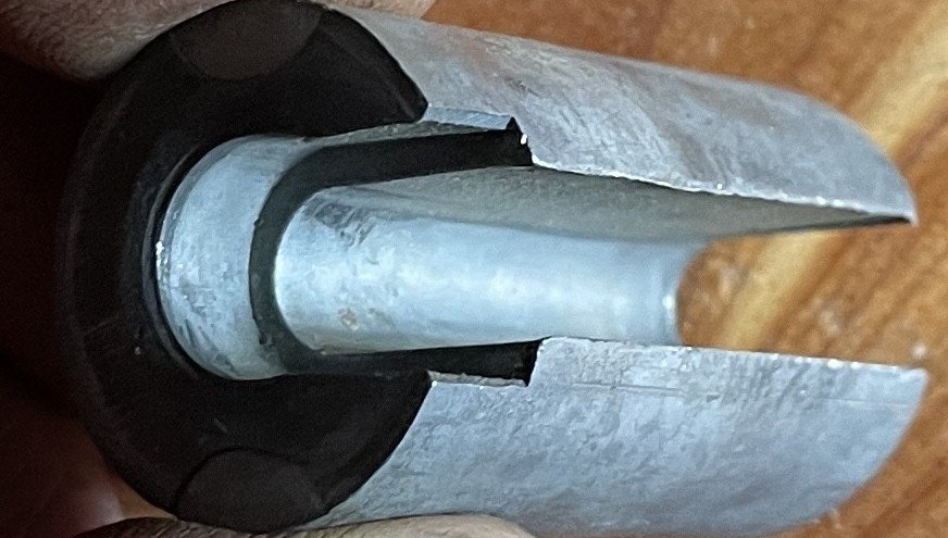

Here are a few pictures of my E bay purchase.
Thanks to Russ / I knew what to search for. :cool: :)
I found the Tapered carriage lock and I am Glad. :D
Also got some extra long carriage lock bolts/ studs.
This would have Taken a Minute to make. :)
I am still debating on making one of these in Bronze :rolleyes: Since I have a pattern now. :)
Dwayne
Posts: 4184
Re: 10ER Lathe Extension
The original Lock Wedges for the Headstock and Carriage were brass on the first few thousand Model 10E's. That soon changed to the Alloy Wedges most commonly seen. As for the reason they changed from the Brass Wedges to the Alloy Wedges is anybody guess. Cost may have been a factor or maybe they decided the softer Alloy Wedges provided a better locking grip. In any case I would recommend staying with the softer Alloy Wedges.

GetterDone
Posts: 357
Joined: Sat Jul 20, 2024 3:45 pm
Location: TN
Post by GetterDone »
chapmanruss wrote: Tue Feb 11, 2025 1:18 pm The original Lock Wedges for the Headstock and Carriage were brass on the first few thousand Model 10E's. That soon changed to the Alloy Wedges most commonly seen. As for the reason they changed from the Brass Wedges to the Alloy Wedges is anybody guess. Cost may have been a factor or maybe they decided the softer Alloy Wedges provided a better locking grip. In any case I would recommend staying with the softer Alloy Wedges.
As always thanks for the info.
I will take your advice and just use this one. :)
I try to always remember the Kiss philosophy :D
Sometimes I stray a little. :cool:
Dwayne
Posts: 35428
Yes I think the softer wedge will deform under load that makes it a more effective clamp. I see the brass as an effort to have it become the wear susceptible part, but the softer metal was an improvement on that.

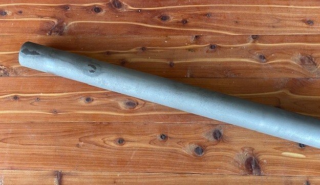

Well, I got a Little more done.
After second bath.
These tubes are (Close to being Ready) :)
This is the other (spare parts) tube that will be cut in half.
It needs a 2nd bath.
This is still Ugly :D
Second bath after scraping it will be a Little better.
Other side of this/ I will take a wetstone and smooth this after 2nd bath. :)
