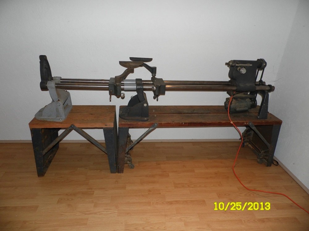

Below are two different examples I have found.
_
Extension Bench 1 r.jpg (83.94 KiB) Viewed 25171 times
The one above uses a bench for the extension providing a solid base for it. It uses more parts than the one below.
_

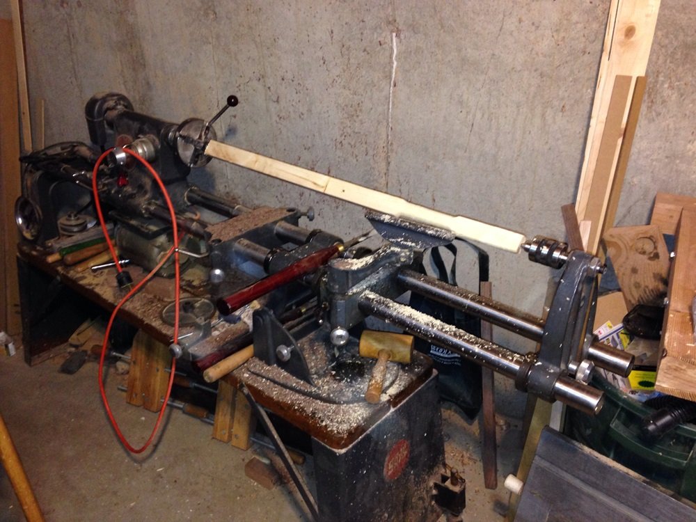

Floating Extension on Model 10.jpg (147.76 KiB) Viewed 25171 times
The one above is a floating design and uses sleaves inside the Way Tubes to hold it in line. The Tailstock location can be moved along the Way Tubes.
In both cases parts of a Model 10 are needed to make them which includes a Way Tube, Carriage, Base and Arm for the Bench one, Tie Bar for the floating one plus other parts.

chapmanruss wrote: Thu Dec 26, 2024 11:59 am Below are two different examples I have found.
_
Thanks for the Pictures.
The second one is the way I pictured doing the setup.
That way I can use the Way tubes in their full length. :D
I just can Not bring myself to cut them :eek: :rolleyes:

Here's a flier from Magna for the factory version of the lathe extension, which is like the one that Russ showed in his second photo. The assembly drawing and parts list may be useful if you make one.

You could make one without cutting a Way Tube shorter. Get some 1-3/4" Tubing for the Way Tube parts. Having full length 52" Way Tubes for the Lathe Extension may be too much weight hanging out there to properly support.
Something to remember is the Way Tubes originally were thicker walled on the Model 10's until near the end of production when they changed to the thinner wall tubes used for the Mark 5.
