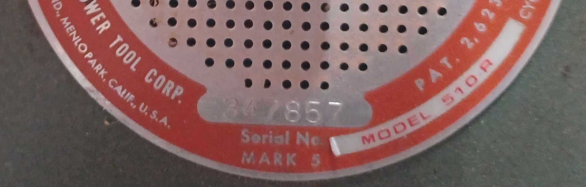

Here is a challenge for the group (from the SS rookie)!
I found a Mark 5 for sale and I asked the seller for a picture of the serial number (see attached pic). Base on the s/n documents & charts I found in this forum, 347857 was built in 1957. Looking at the picture from the add, there is what looks like a sticker with 'Model 510 R'. Does this mean this unit a greenie that was upgraded to the 510 table? It sure looks green to me???
Thanks for any/all feedback!!!
- SS Mark 5 with odd vent ID info.jpg (112.45 KiB) Viewed 48803 times
- Is this a greenie.jpg (272.5 KiB) Viewed 48803 times

Re: Everything Mark 5 / V - Technical info, documentation, links
Yes. The 510 upgrade came with that sticker. See this thread about 510 table compatibility: viewtopic.php?t=36356
Thanks edma194!
That also explains the last Mark 5 that I acquired. It didn't have the sticker but did have the 510 table upgrade. I now understand that for any used SS, there could be lots of different combinations to determine it current state. Amazing to me that were are so many, but that shows how well and backward compatible these systems can be.
