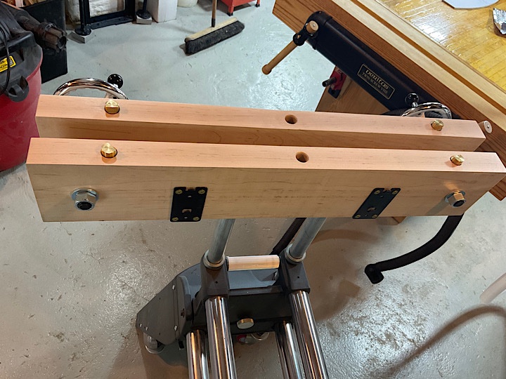

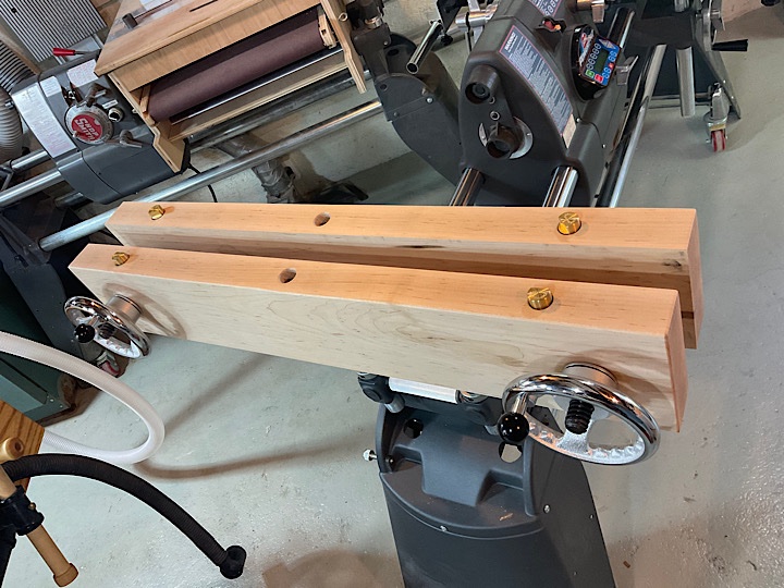

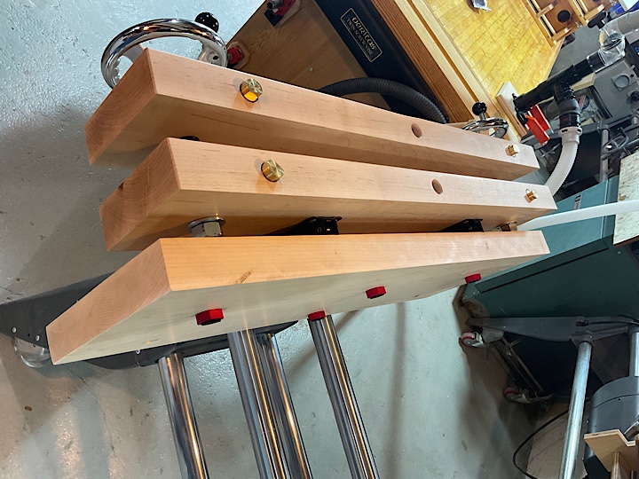

Some progress. Brackets arrived today, one is bad, doesn’t have mounting slots so I’ve got replacements comming. But was able to get it rough mounted. So now it’s on to drilling some bench dog holes, sanding / cleanup, & finish.
With the work top removed
With the work top folded

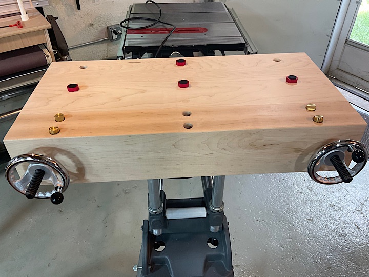

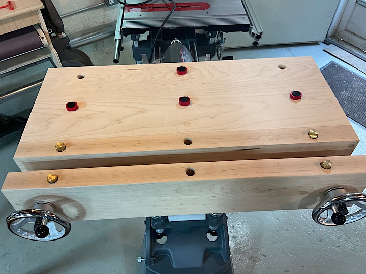

Moxon Vise / Mini Workbench complete. I decided on Veritas Prairie Dogs for the jaws with some aluminum (in removable top) ones for added flexibility. I’m real happy with the way it came out. I can see having a small height adjustable work bench will be a great addition to the shop.
Thanks again Cheechako, for the idea & inspiration….
Front views with additional top attached Side view with top dropped down
Front view with top removed
Rear view with top removed.
