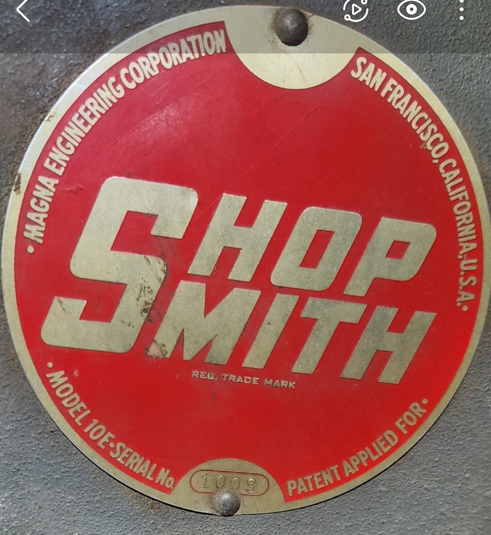

Hello. I have owned several Shopsmiths over the past 35 years.
I was reading through this forum, started reading about SN of early 10E. The one that I have had for about ten years is SN 1009. Maybe the 8th production 10E?
Please let me know what you think!

MCrabb,
Your Model 10E serial number 1009 is not only from the original 250 units made that started it all but is now the lowest serial number I have seen. It was made/shipped in November 1947 to one of the West Coast Montgomery Ward Stores. It is believed the Model 10E serial numbers started at 1001. Low Model 10E Shopsmith's serial numbers with an E prefix (E1143 is an example) were made later when an Eastern Plant went into production. There are Model 10ER Shopsmith's with lower, 3-digit serial numbers, but they were made later in Australia.

Hey! Thanks for the nice messages.
I bought it 10ish years ago at an Estate Sale in Dalton Gardens, Idaho. They said the estate owner bought it new. I put in storage and it's been there since. This week I will assemble it and post more pictures.

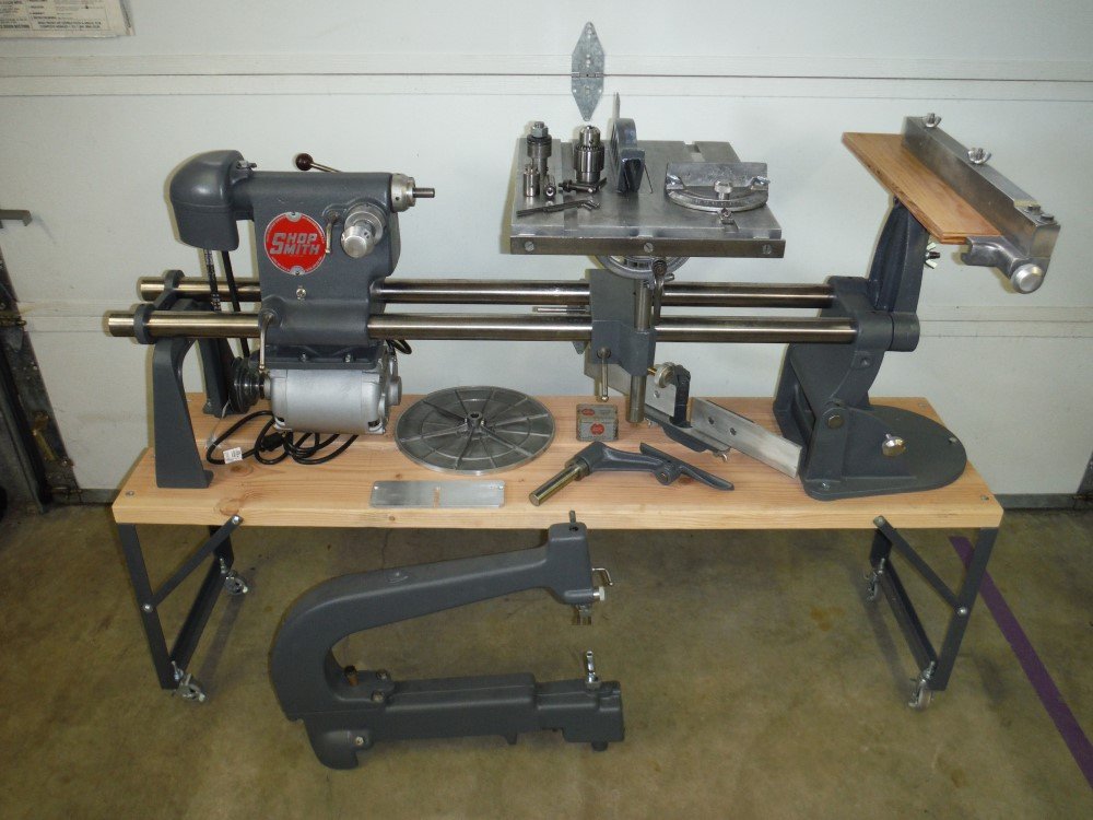

PAGuido,
Serial number 9631 is probably from very early 1948. We like to see pictures which can also be helpful when asking questions about thse tools. Below is Shopsmith Model 10E serial number 8865 I restored several years ago. It would be very close to yours.
10E 8865 r.jpg (116.22 KiB) Viewed 50748 times
It is complete as it came from the factory plus has the Model A-34 Jig Saw, the Shaper Fence and Jointer Head in the gray box. The wood Extension Table is a replica I made for it since the original one was in bad shape. It is on a bench I made.
Even with this early into production Model 10E there had already been changes made to it. This one has the second (of 7) version of the Headstock and the Quill Collar has changed from the original. Many changes were made to the Model 10E and 10ER during their production.
