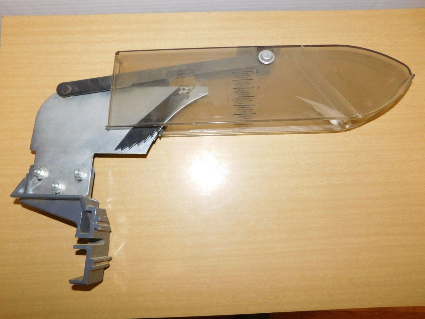

Photo 1: The common aluminium upper/lower that we all know.

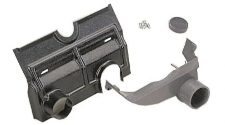

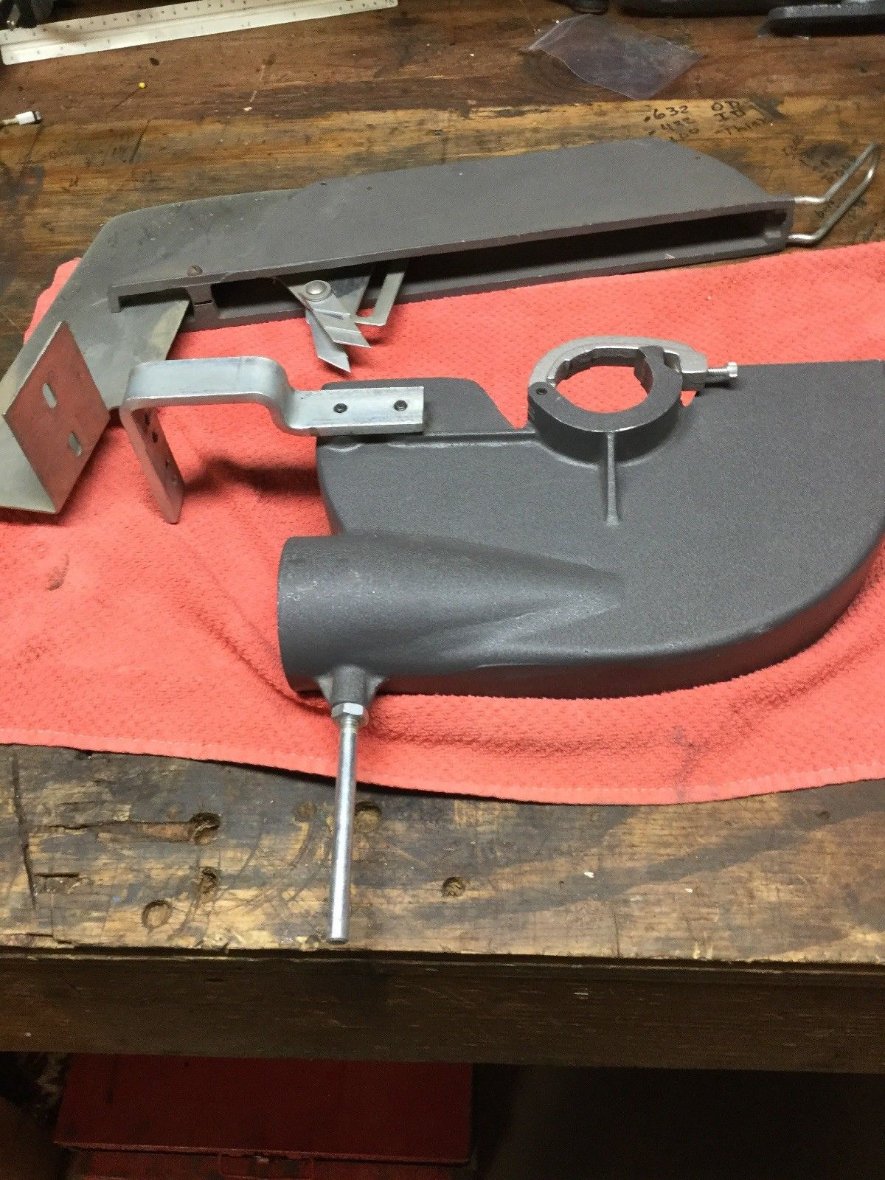

Photo 2: An upper assembly with a built in splitter and mounting block. What does this actually attach to on the machine? Does it work with any table, or does it require a drilling template?

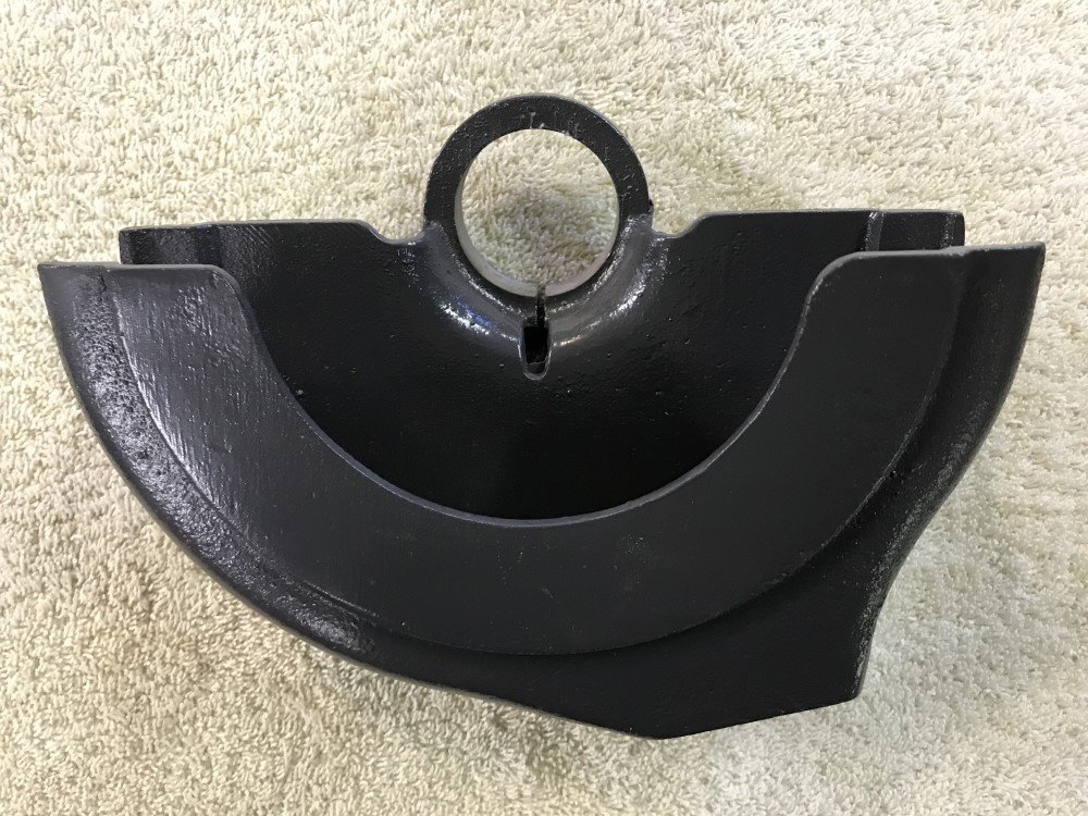

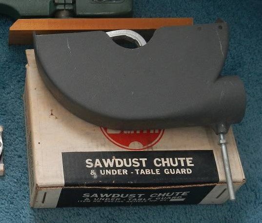

Photo 3: Different again. Similar splitter to photo 2 but it has an aluminium lower guard securing piece. Is this a hybrid setup or just listed with a lower included?

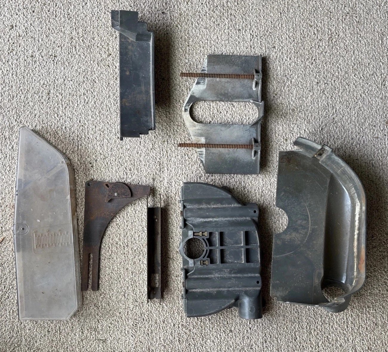

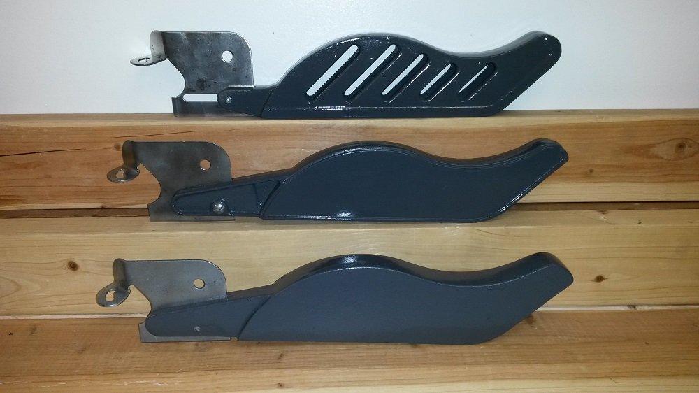

Photo 4: A full kit, different again. Different slot in the splitter and different accessories. Almost looks like a 510/520 setup but seller claims it's for the 500.

- I don't recognize the guard in photo 3.
- I think photo 4 shows the lower saw guard disassembled, but that is not the upper guard that goes with it.

- The for the final version of the Mark V-500 saw guard, the upper guard is in photo #2, it mounts on a block that is attached to the rear table post. When buying used that block has often gotten separated, and is missing.

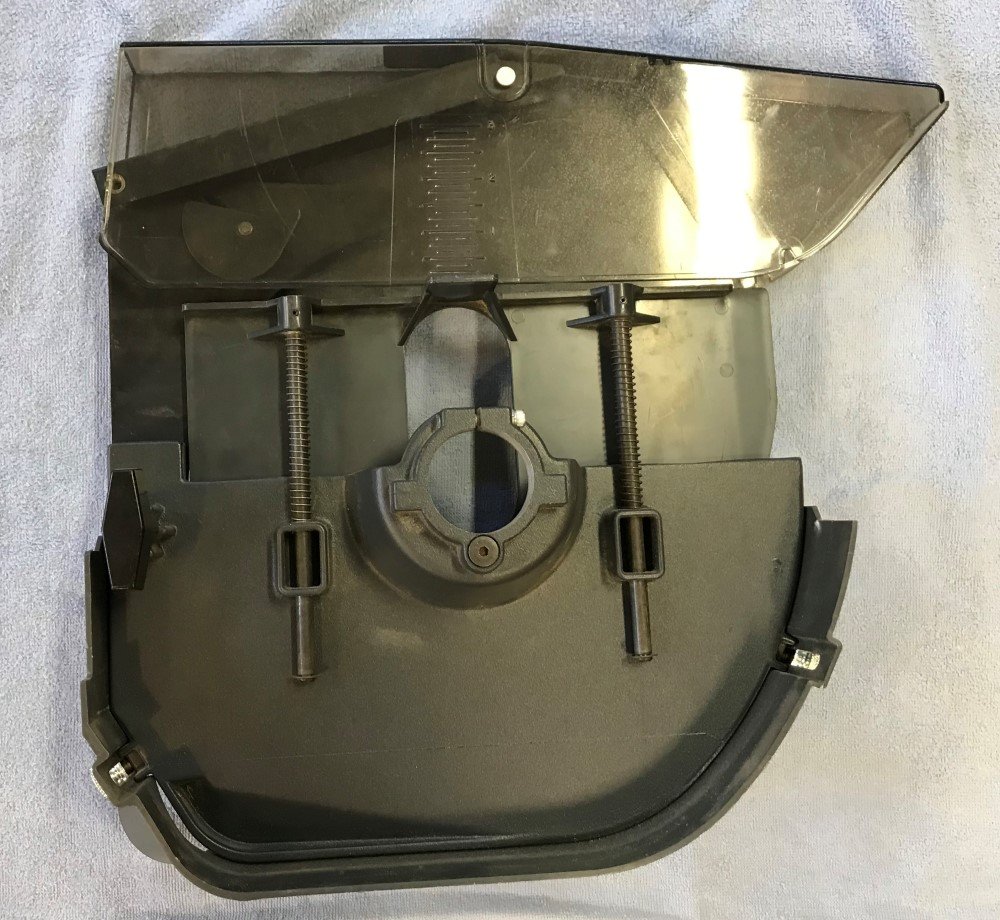

You have done a great job researching the various versions so far. I can add the following comments:
1. Photo 1 is the system supplied with my 1980 version.
2. Pretty sure that Photo 2 is the only upper guard upgrade available. Making sure the mounting block is included was good advice. This is the upper guard I have purchased. This upper guard can be used with ANY suitable lower guard (the original or an upgraded lower guard). I still use my original lower guard.
3. Can't be of much help on Photos 3, 4, or 5, except I think there was an upgrade for lower guard with only one exhaust port, and then an upgrade to it to add a second exhaust port.

Thankyou!br549 wrote: Mon May 18, 2026 6:55 am You have done a great job researching the various versions so far.
I am a dummy. I just did another deep dive and I was literally told to read this thread below a few days ago by the author who posted all the damn guards perfectly in order with a little history on each!
viewtopic.php?p=285672#p285672
I think this answers literally all my questions.

The Lower Saw Blade Guard in your third picture was originally released with the Mark VII in the 1960's and is why it is not in the Mark 5 link above. It used the same upper Guard (seen below) as the one in your 1st picture. That upper Guard you show does not belong with it or any Mark Saw Guard set.

Your 4th picture is a collection of miscellaneous Saw Guard parts that don't all go together.

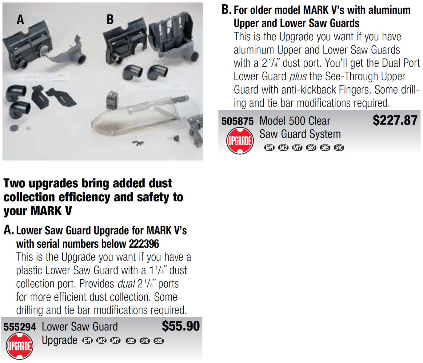

I found a 96 page catalogue online with the original sales text for 555294 and 505875
- Product Catalog 555294 and 505875.jpg (228.44 KiB) Viewed 2248 times
