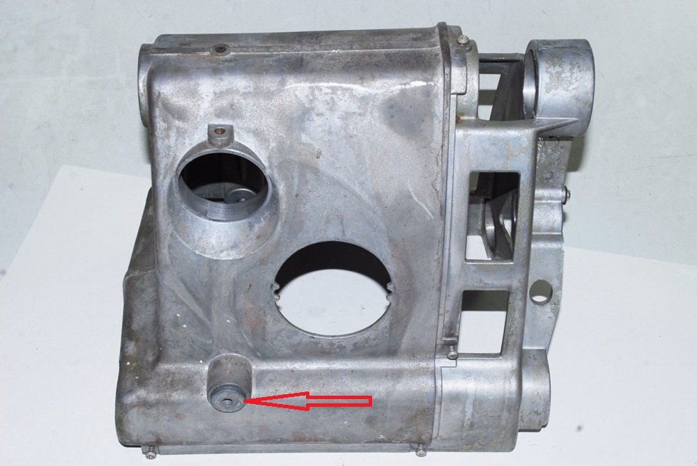

A couple things come to mind. The locks could be sticking a bit and not fully releasing the pressure. Turn to unlock them all the way and see if the lock wedges are moving out then back in when turning to lock in the Headstock Casting. When turned all the way to unlock the wedges should protrude slightly as seen in the picture below of the back side of the Headstock Casting. The front wedge will come out behind the lock handle. They could be mis-aligned causing a problem.

The other cause would be the rotation of the Way Tubes. There can be a very slight bow in the Way Tubes causing them to be further apart over the length of the tubes. Rotating the Way Tubes to get the Headstock and Carriage sliding smoothly will correct that cause.
