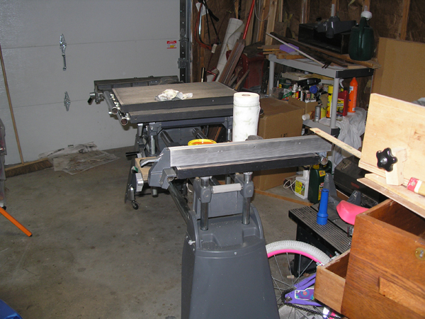

For once, I don't have a problem but just felt like rattling on about my progress. I bought the 510 several months ago (mainly for the jointer that came with it) and I have been cleaning (lots of mud dabber nests in every nook and cranny), de-rusting, adjusting and generally getting it up and going.
Tackled the jointer first and have it all cleaned up and ready to go. Pretty much completely disassembled it, cleaned and then reassembled it. Replaced the blade mounting screws with all new SS screws and lock washers and re-tapped the holes (thanks to Bill Mayo for his hints). Still have to align the blades and actually use it for the first time.
On the 510 itself, did a lot of cleanup, waxing and lubricating. Had a little panic when the quill turned out to be stuck but, with the help of the folks here, I got it out and all freed up. Finally fired it up for the first time yesterday and it protested a bit and took the breaker out twice (I have GOT to get the electrical updated to 20A dedicated circuit(s)!!). Got 'er running by starting at slow speed (makes a big difference) and got some running time on it. HooRah!!
Now get some more of the missing parts, align the table, fence, et al and maybe make some sawdust with it. Really need a box under the SS to hold all the parts and pieces.
