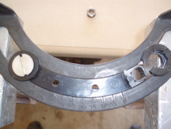

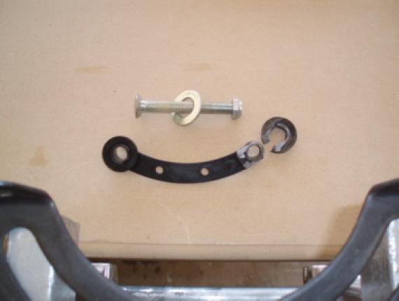

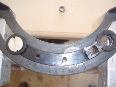

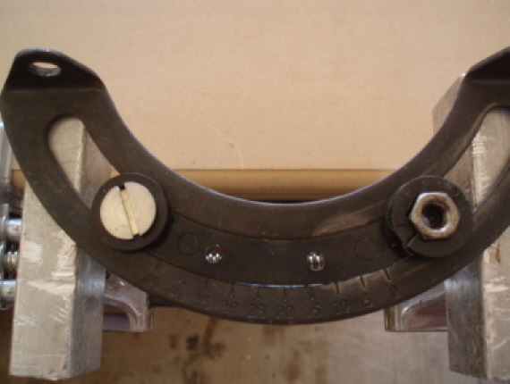

Dusty - thanks for the pictures, I think that helps solve the mystery. Looking between the current parts diagram on the SS site and the one I have from my 82 Owner's Manual, the trunnions and bushings are the same. However, it appears SS upgraded and took off the "wing bolts" and replaced with hex bolts and the trunnion supports on each side. Shame they are plastic, as your picture shows what will happen if over-torqued. In my shopping cart on the SS site is a pair of these supports - two for $5.32 instead too bad.

I will have the same (and maybe some more) added to my cart today. I have removed the table from my bandsaw and have found that my trunnion supports are also damaged. As you have said, probably from over tightening.thainglo wrote:Dusty - thanks for the pictures, I think that helps solve the mystery. Looking between the current parts diagram on the SS site and the one I have from my 82 Owner's Manual, the trunnions and bushings are the same. However, it appears SS upgraded and took off the "wing bolts" and replaced with hex bolts and the trunnion supports on each side. Shame they are plastic, as your picture shows what will happen if over-torqued. In my shopping cart on the SS site is a pair of these supports - two for $5.32 instead too bad.

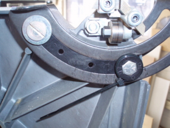

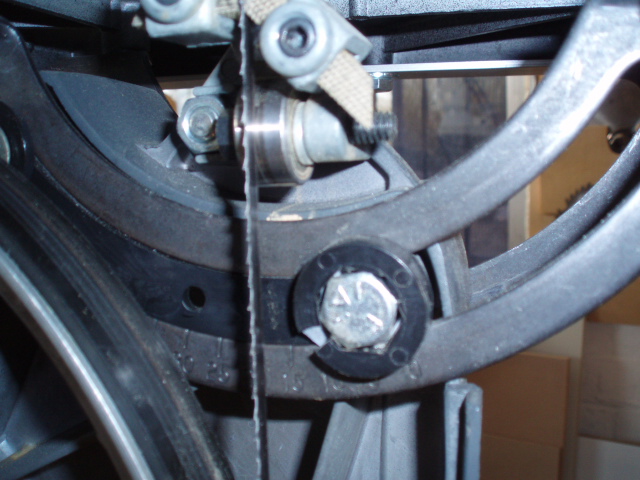

I have ordered repair parts again. Some for now just in case I need them. Well, some of what I ordered are not repair parts. They are items I want in the shop just in case I need them - like t-nuts.
But the order was actually prompted by this thread. I discovered that I had a pair of band saw trunnion supports that were cracked. I did a bit of kludge repair (using a tie wrap and a bit of plastic adhesive) and put the band saw back in service but I ordered repair parts as well.
Some photos of what I did to get it back in service. This is NOT a recommended procedure.
