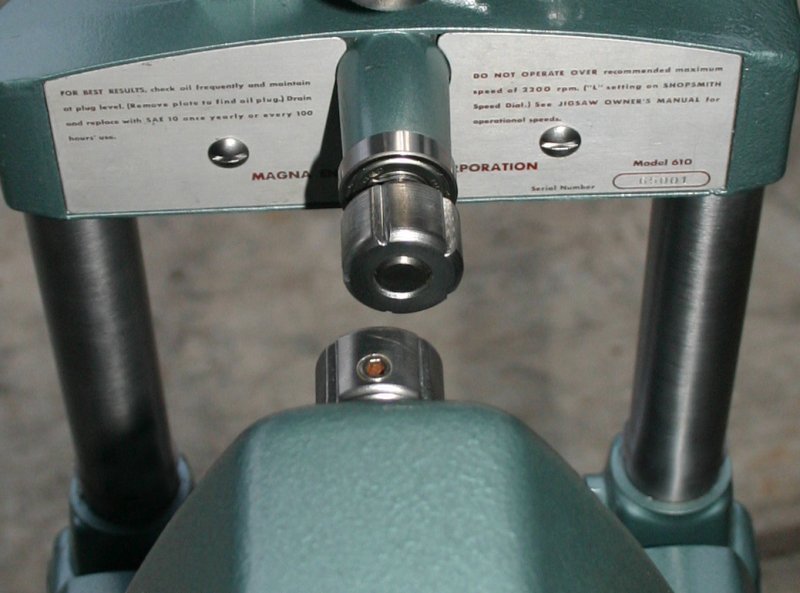

I ran into what I hope to be my last Greenie restoration topic. I completed the restoration of the jigsaw that came with the unit. (Photos of the finished unit to follow later today). I covered the disassembly in a different thread titled "Jigsaw head removal - The Nut Reinstallation".
When I put the jigsaw on the Greenie, I noticed that the alignment of its drive shaft to the drive shaft of the Greenie was off by 3/8" or so as show in the picture below.
[ATTACH]4738[/ATTACH]
Since the jigsaw tubes that drop down into the headrest are straight vs. eccentric, there was no apparent way to make an adjustment so I had to consult with the expert. Here's an excerpt of his email reply.
billmayo wrote: There are eccentric mounting tubes (#5137769) that allows alignment of the jigsaw and strip sander. Since I have collected quit a number of the straight mounting tubes, I cheat when doing this alignment. I just loosen the bolts that clamps the way tubes under the jig saw. I twist the headrest using the jigsaw mounting tubes (2X4 between them) until the headstock and jig saw hubs align properly. I have made 2 small saw horses with notches for the bench/way tubes that allows the caster when extended to just touch the floor. This way when I loosen the way tube clamp, there is very little weight on the headstock to way tube connections. This allows me to move the headrest on the way tubes with very little effort. This is not part of any Shopsmith instruction or procedure, just my way of doing it.
So, I'll try this approach later today. Hopefully it will be as easy as it sounds.

Posts: 35430
1) Have you assured that the SS is level?
2) Does the Greenie have the adjustment screw on ONE side of the endcap"
3) If so have you 'adjusted' it?
Thought of these AFTER reading Bill's reply!
P.S. This provides very little range. Bill's method seems much more effective. I was originally thinking he was causing rotation of the way tubes, NOT end cap rotation!

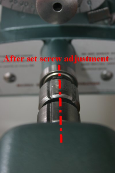

JPG40504 wrote:1) Have you assured that the SS is level? Yes
2) Does the Greenie have the adjustment screw on ONE side of the endcap" Yes
3) If so have you 'adjusted' it? ....No. I'll go check it now. :eek: :eek: I forgot all about that set screw. I believe that you are talking about the one that is threaded into the headrest that contacts the bottom surface of the way tube tie bar (ref #25).
I hope it is the set screw. That's an easier fix. - mickyd

mickyd wrote:I hope it is the set screw. That's an easier fix. - mickyd
All I can say jpg is "BEAUTYISOUS!!!"
[ATTACH]4739[/ATTACH]

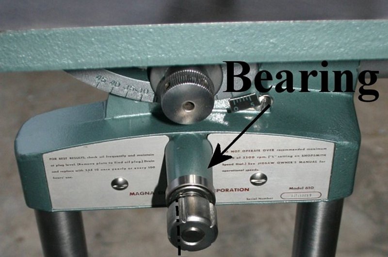

Jigsaw Mystery Bearing
Post by mickyd »
JPG40504 wrote:dIDJA EVER FIND OUT WHAT THAT BEARING IS FOR?????????
The "mystery" bearing jpg is referring to is the one mounted on the jigsaws drive shaft, directly outside the housing, facing the headstock. I had already ordered a replacement bearing prior to questioning what it was there for ($25 with shipping....ouch). I couldn't understand what the bearings function was since for one, it's a slip fit on the drive shaft and two, the outer diameter is just hanging out in space. See photo below.
[ATTACH]4763[/ATTACH]
FYI - This bearing is NOT shown in the jigsaw owner manuals exploded view or parts list. Instead, it shows a stack of 2 washers with a retaining ring (aka snap ring).
I ask Bill Mayo what the bearing was for and he said that it serves as a “thrust bearing”. If a force is applied to the drive shaft toward the jigsaw, the side of the bearing will contact the face of the jigsaw housing and allow the shaft to continue to rotate smoothly. I can see why they changed the design from two washers to a bearing for this reason BUT it would seem that washers may work just as well since with proper positioning of the headstock to jigsaw, the coupler should not cause the shaft to push in toward the housing. Maybe I’m wrong but I’ll find out when I actually use the thing. Washers are a tad cheaper than that bearing also!!!
