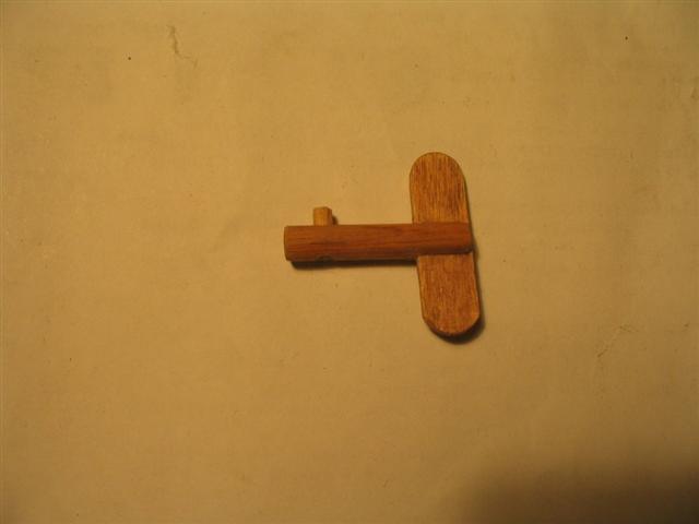

the safety key is part #513411 and currently $4.52. the length of the belt could be determined by measuring with a tape around the pulleys. you id not say what tool you are putting on the stand and i'm not sure if all spt's use the same belt. ie: different pulley sizes. the length may not change that much bit i don't know for sure. i made my own replacement keys from a piece of 1/4" dowel with a short piece of 1/8" dowel and a piece of a popcicle stick for the handle.
A picture or pictures of the replacement key would be GREAT!

ok, here is a pic of my "replacement saftey key" and for what it's worth the belts on my proplaner and bandsaw are both 38 inches long by 1/2" wide.
- IMG_7330 (Small).JPG (17.96 KiB) Viewed 8302 times
Thanks for giving me a "Now why didn't I think of that?" moment!
