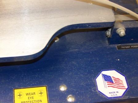

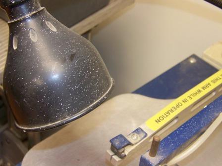

Recently aquired scroll saw that has paint spatter on it. Any ideas on a way to clean it off?
[ATTACH]5350[/ATTACH]
[ATTACH]5351[/ATTACH]
Thanks,
Duane

Some suggestions on this site might work. Stop by a paint shop and see it they have any suggestions.
Rubbing alcohol (3% isopropyl alcohol from grocery store) may work.

[93%] might work better!:D IF latex base. If oil base, something stronger. Mineral spirits and elbow grease. Any thing stronger may also remove the 'original' finish. Try goo-gone!bucksaw wrote:Some suggestions on this site might work. Stop by a paint shop and see it they have any suggestions.
http://homeimprovement.lovetoknow.com/R ... wood_Floor
- robinson46176
- Posts: 4182
I would probably try mineral spirits first.
Next would probably be some kind of rubbing compound, maybe automotive just because I have a good bit of it on hand.
You could also try Pumice or rotten-stone.
Another option and one I am good at is to just ignore it.
- a1gutterman
- Posts: 3653
Wonder what the main ingredient is????ddresser wrote:Thanks for the suggestions. Paint store had something called Oops to remove dried latex. That got most of it off and if I don't look thru the bottom of my bifocals can't see the rest.
