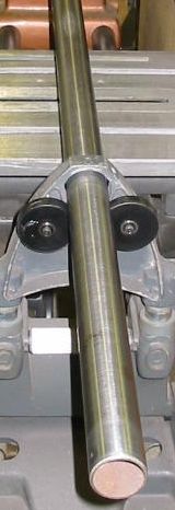

IF you have a second SS this part I made worked when turning down some rusty tubes I have for some ER's
What do you think?

What did you use on the 'chuck' end?wlhayesmfs wrote:IF you have a second SS this part I made worked when turning down some rusty tubes I have for some ER's

It is a standard 4 jaw chuck Will try and to post a bigger picture

I have made a few of these using the softer caster wheels. The mounting holes in the tailstock are slots that I drilled and filed so the casters can be adjusted. The tail stock remains fully functional. I use a 3 internal jaw 4" metal lathe chuck with a 5/8" adapter to hold the tubes. Really does a beautiful job on the tubes as I can clean, polish and wax them. I also find bent tubes when mounting them in this setup. This tube was 100% rusty and not fully cleaned yet. About 5 minutes of work so far for this picture.

Bill, great idea and even easier to build that what I tried. I had an extra tail stock and never thought of that. I guess that is why we all turn to you because at one time you have probably already done or tried it.
Thank for the picture. Now I know what I will make next
