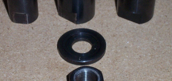

keakap wrote:If trouble getting a 5/8 555608, you could also try to locate a 505506 5/8 arbor but NOT the current 505506, which is listed as the Moldy/Dado arbor not to be used with a single blade. Older versions of the 505506 arbors were called "Universal Arbor" and were approved for use with single blades or others (dado, for instance).
Just arrived: a 505506 Moldy/Dado 5/8 arbor, ordered to go with the Dodo blade set from SS (which happens to be 6").
This is a New Version.
In the o/l catalog the 505506 "Moldy/Dado" is listed as being 3-1/8" in length and including a 3/4" spacer, and other stuff.
***Cat.: "505506 Molder/Dado Arbor
Here’s a great all-around Arbor for use with Dado Blades or the Shopsmith Molder Head.
Includes a 3-1/8” long 5/8” diameter threaded shaft, two steel washers, a 3/4” thick spacer, a locking tongue-washer and a hex nut. "***
The one that just came is 3-3/8 long (like a former 505506 Dado). It includes a 5/8" spacer, like my other "Universal" arbor and Dado arbor have.
The new one has a 1-1/4" (x 1-1/2) body, like one of my others (the third is 1"). My other two 505506's are 3-1/8" long.
A "Glitch": the cleanest one is the new one. At least one of the others definitely came with the "Universal, 505506" label (I think both). It may be possible that the second oldie was named "dado" arbor (but also 505506).
What fascinates me with this new version is that I had heard that the difference that made the "Moldy/Dado" arbor was the additional length, 3-3/8 vs 3-1/8. Yet the on/line description has now been changed to 3-1/8, but the "Moldy/Dado" arbor I just got is indeed 3-3/8.
I checked and could not find any indication on my caliper that it was made in the Bermuda Triangle.
[ATTACH]6157[/ATTACH]
[ATTACH]6158[/ATTACH]
[ATTACH]6159[/ATTACH]
Arbor, Molder/Dado
Very Interesting. I have checked my arbors with the intention of being some help. But it did not work that way.
I have the Shaper Arbor (555117) and three identical Molder/Dado Arbors. The Molder/Dado Arbors are all 3 3/8" long (overall length).
The Shopsmith catalog reads slightly different.
Includes a 3-1/8” long 5/8” diameter threaded shaft, two steel washers, a 3/4” thick spacer, a locking tongue-washer and a hex nut. Fits all MARK V models.
The threaded shafts, on mine, are only 1 7/8" long. The overall length is 3 3/8". The spacers are 5/8" thick. I also have locking tongued washers with each.
Why do I need tongued washers? These all mount in the same location as a table saw blade (ie, they rotate in the same direction as a saw blade).
I have no idea when the 505506 changed from 3 3/8" to 3 1/8" long or why?

dusty wrote:...three identical Molder/Dado Arbors. The Molder/Dado Arbors are all 3 3/8" long (overall length).
...Includes a 3-1/8&#8221]Why do I need tongued washers? These all mount in the same location as a table saw blade (ie, they rotate in the same direction as a saw blade).[/font]
Ah, so, paleoShopsmithology is fascinating, aint it?
Ironically I ordered the new Moldy/Dado arbor, even though I already have two "Universal" (or moldy/dado) arbors, specifically because the catalog at the moment I ordered it listed 505506 as 3-3/8" long and with a 3/4" spacer, neither of which I had. At least I got the 3-3/8 unit. Frankly, if I ordered another 505506 Moldy/Dado Arbor today I have no idea what might come in the mail. (not that it matters.)
Your moldy/Dadoes are 3-3/8 long, and the catalog used to describe the 505506 as 3-3/8 long.
The 505506 used to be 3-1/8, then changed to 3-3/8, now back to 3-1/8, both in the Catalog and in reality. Don't know why.
The 5/8" sections: 3-3/8 version has longer threaded area, otherwise ~ same.
As for the tongued or keyed washers, since the 5/8 arbor threads are cut in the reverse of the left-hand SS 1-1/4 arbors the keyed washer is required, Always next to the nut, to prevent the nut from slipping loose (in effect, since the washer is keyed to the spindle it helps "key" the nut to it also). The Shopsmith Bulletin label used ALL CAPS when they pointed out the necessity of using that washer and in making dang sure the nut is put on Tight! (unlike the SS 1-1/4 arbors).
Notice the different arbor shaft diameters?
