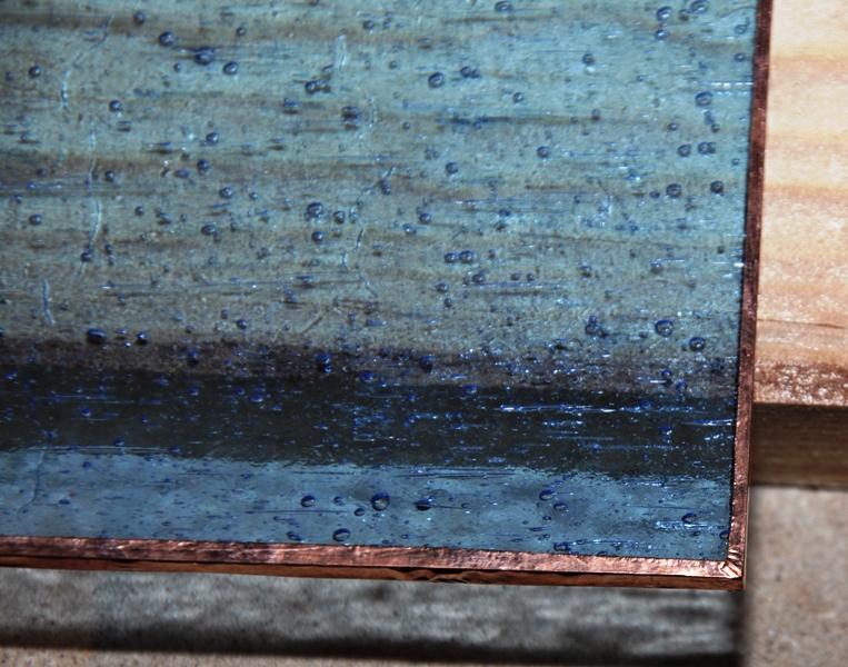

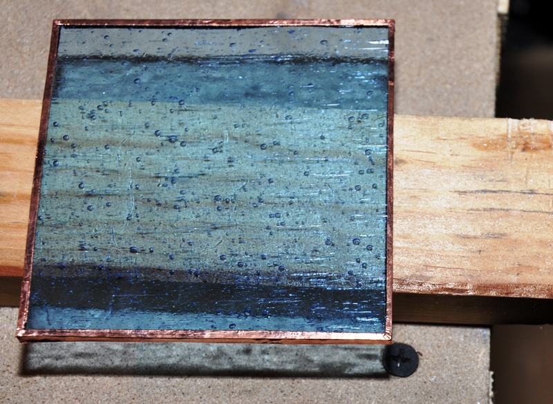

Since the glass window will be near horizontal I am adding copper foil to the edges of each piece of glass. From what I have read this will increase the strength and help prevent sagging. I am using 7/32 wide foil to wrap the edges. Last night during the Colts game, I wrapped several cut pieces. I used a round piece of wood to smooth the foil.
If I had not sanded the edge (in the prior post) then the foil would have a bulge in that area and would not fit well to the next piece.
[ATTACH]6595[/ATTACH]
[ATTACH]6596[/ATTACH]

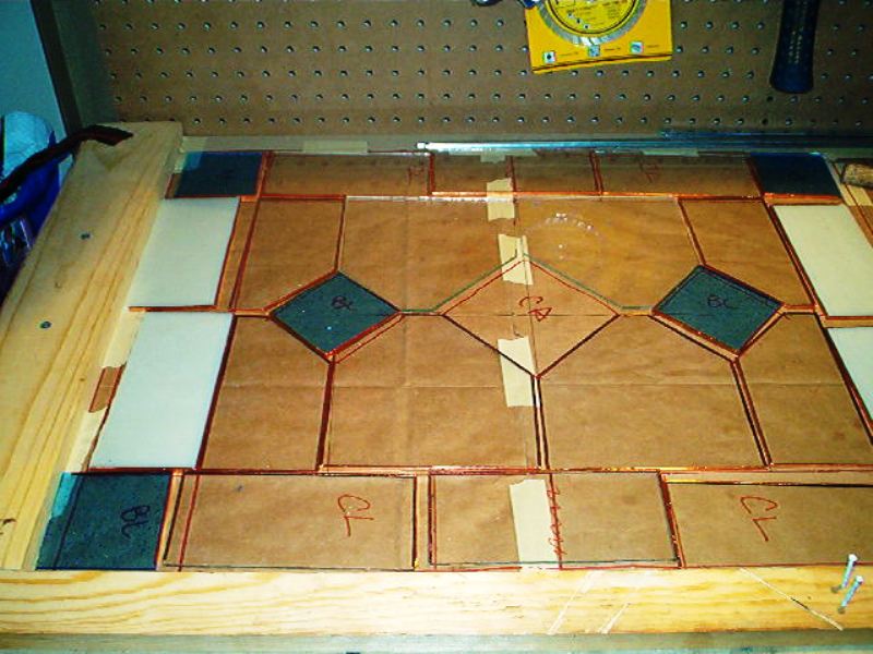

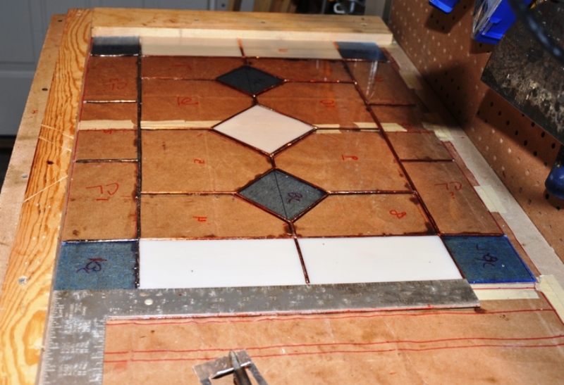

Because it continues to rain, I have had ample time to work on the window.
Remember, this is my first attempt at a making a stained glass window. Therefore, I am not claiming that this THE way to make a window, only that it is the way I am making a window. For those among us who have experience in this field please feel free to critique my methodology, or add suggestions.
I have wrapped all edges in 7/32 black back copper foil. I plan to use a black patina on the solder. The back of the copper foil will be visible through the clear glass and show contrast between the black solder and the copper. The black back of the foil enables the seams to be all black.
As you can see in this photo, all pieces have been cut, wrapped in copper foil and loosely placed on the pattern. I used white pine to make a 90 degree corner on the work bench and I am using my framing square on the opposite end.
[ATTACH]6614[/ATTACH]

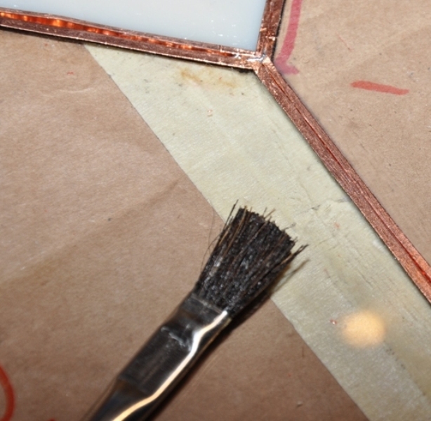

To hold the pieces in place some people use pins or push tacks. I decided to place a small amount of solder at the joints, keeping the piece square and true to the pattern. Should I need to move a piece I only have to heat the solder. I have a paste flux that I apply sparingly to the copper foil with an acid brush. I only add enough flux to make the copper “hazy.”
[ATTACH]6615[/ATTACH]

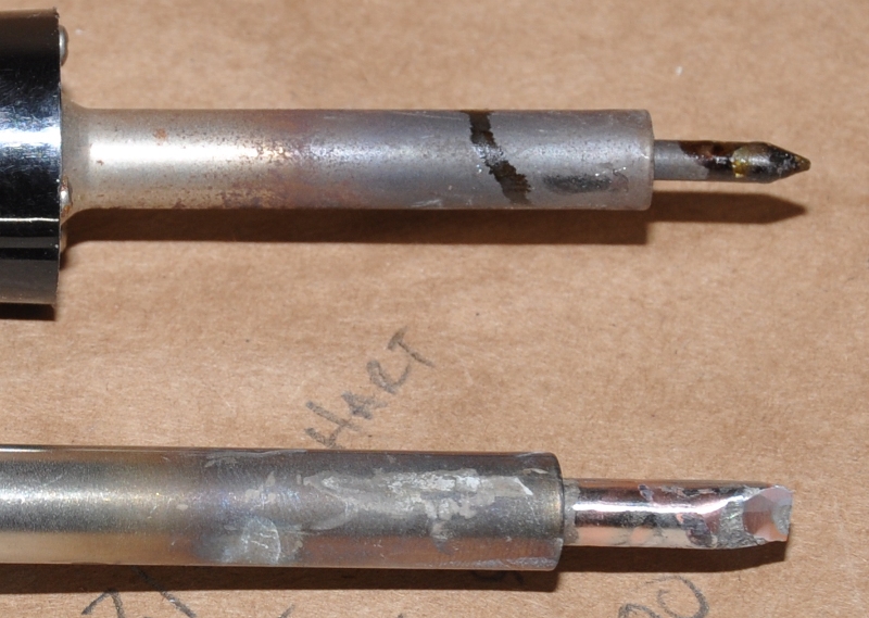

I have an old 25 watt iron (top) and purchased a 40 watt iron (bottom). The 25 watt was not of sufficient power to melt the solder and the pointed tip did not work well. The 40 watt works ok and the wider tip covers the joint.
[ATTACH]6616[/ATTACH]
I have noticed an accumulation of “crud” on the tip of the iron and have removed it with 100 grit paper. If anyone knows of a better way to remove this build up please let me know.

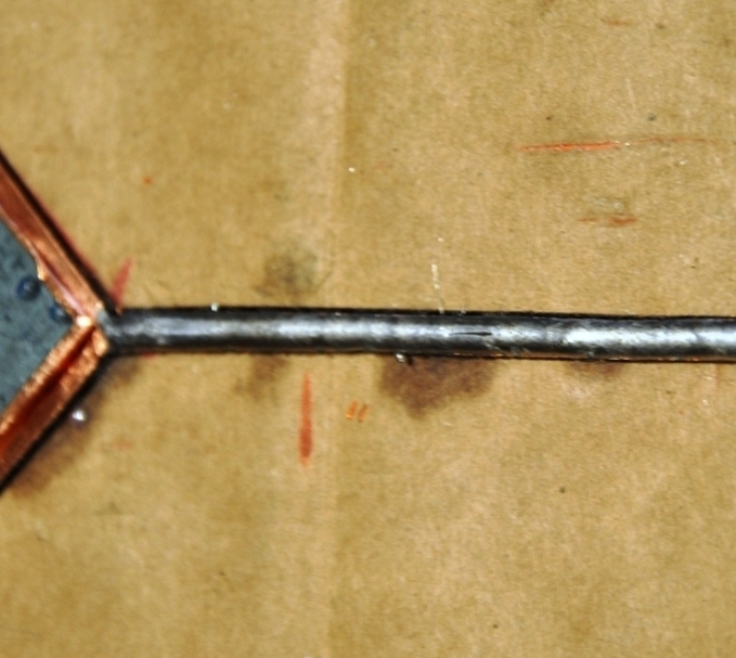

The goal is to get a nice even and smooth joint. I try to do a single joint in one pass. I found that if you stop in the middle of soldering a joint then there will be an area of demarcation and it is somewhat unsightly.
[ATTACH]6617[/ATTACH]
