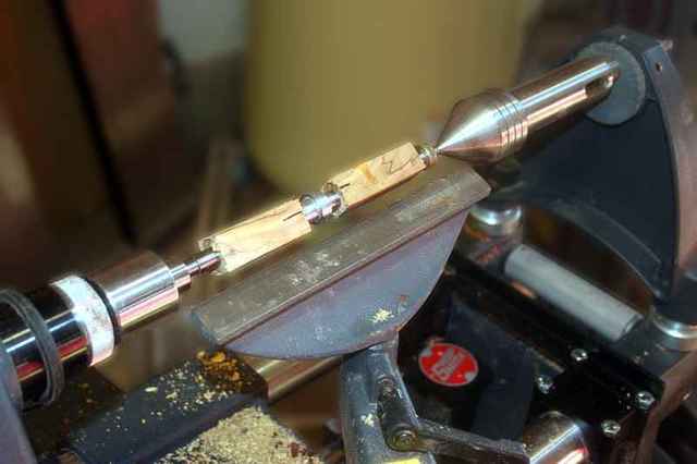

fjimp wrote: I should mention you will want to line the live center and the mandrel up by installing the mandrel into the headstock and then move the headstock and if necessary the quill to where the tail stock almost touches the end of the mandrel. Then line it up so there is no side or top/bottom tension in alignment. Good luck. Jim
You mentioned the tailstock. This is with the live center installed also. Correct?

cocacola1012 wrote:You mentioned the tailstock. This is with the live center installed also. Correct?
Here's a pic of the mandrel mounted on the quill and a live-center on the tailstock. I am also using a morse taper extension between the live-center and the tailstock due to the fact that I have a lift assist kit on my MkV and that keep the carriage with the toolrest from sliding all the way to the right end of the tubes.
[ATTACH]6717[/ATTACH]
