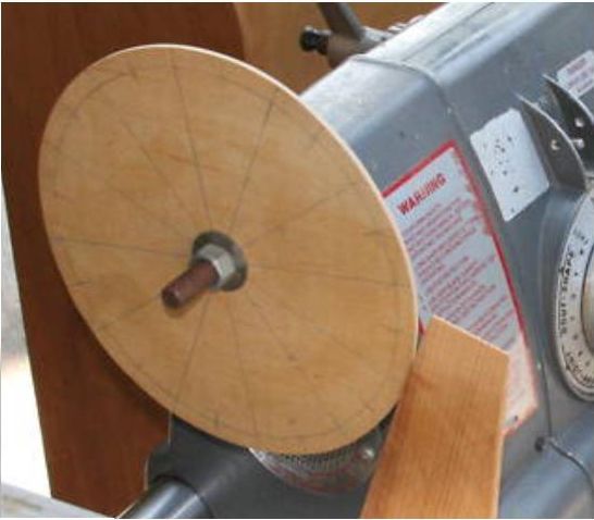

That is one of the machines that gave me the idea to go this way instead of the hanging cabinet. What do you think the Disk on the upper accessory drive is for? Disk sander? Nice setup seems very well thought out maybe I should just build to the legs. Though it seems that a cabinet with 90 degree corners would be the least demanding build.

I think the disk on the aux end output shaft is a indexing wheel. Notice the piece of wood on the outside of it coming up from the way tube. The disk itself is probably drilled with holes at 0, 30, 60 90, 120,180 degrees etc. This allows something mounted on the lathe to be indexes.
Say you wanted to cut 4 flats on turned cylinder. You would index the piece by stick something through the board and index wheel and then sand/cut the top of cylinder flat. Then you would remove the pin and turn the cylinder to 90 degrees and do the same thing, repeating agian at 180 and 270.
Or perhaps you would like to flutes around the cylinder you would start at 0 degrees and do your flute then you would move to 30 degrees and so on. I'm sure you get the idea.
Plus have the disk mounted you can always use it to turn you quill when the need arise. Good addition for your Shopsmith if you do any indexed turning or have trouble turning the quill by hand to get the flat where you want it to mount something on your SS.

FWIW, that index wheel is marked off in 15&#176]No [/B]holes!
The board attached to the waytube is an index pointer. I do not see a method of clamping it at a given position. Considering its radius, it has to be quite accurate.
Excellent design. Kudos to whoever did it(probably the same individual who designed/built the storage stuff)! Only improvement I can offhand think of is to drill a 12" sanding disk instead of the wooden disk and 'steelize' the index and add a detent pin.(overkill!!! but better)

Now I thought it was a buffing wheel.
beeg wrote:Now I thought it was a buffing wheel.
I was with you, beeg. But then I can't see the 15 degree index marks so JPG has clues that are hidden from me.

dusty wrote:I was with you, beeg. But then I can't see the 15 degree index marks so JPG has clues that are hidden from me.
sorry, the lines were more visible in one of the pics that I didn't dload. they were also more visible in the pic that I posted before I re-sized it for here.
I was looking at that other pix(on e-bay). I magnified it greatly to see the detail.

When I said it was drilled so a pin could be inserted I was thinking that the builder of the index wheel copied the pattern of most index wheels that come on some lathes. They usually have a pin or heavy detent that holds the wheel and the turned piece rigidly in the indexed position.
I can't imagine trying to clamp it rigid but then I haven't tried it so I don't know if it would work or not.
Always wondered what kind of mess you could have if you had the index pin in position and forgetfully turned the machine on. My guess the motor would just stall and you would catch the mistake quickly. Worst case blow a breaker or fuse or even the motor I guess.:eek:
