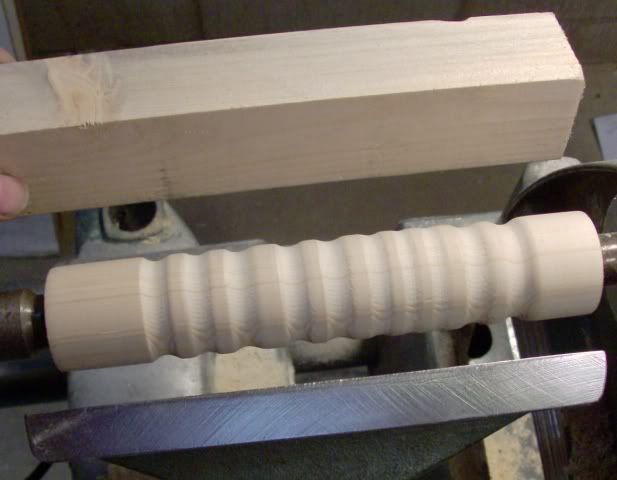

My very first try. Unfortunately, I did not take a "before" picture, but it was on 2" X 2" ripped from a regular 2 X 4.

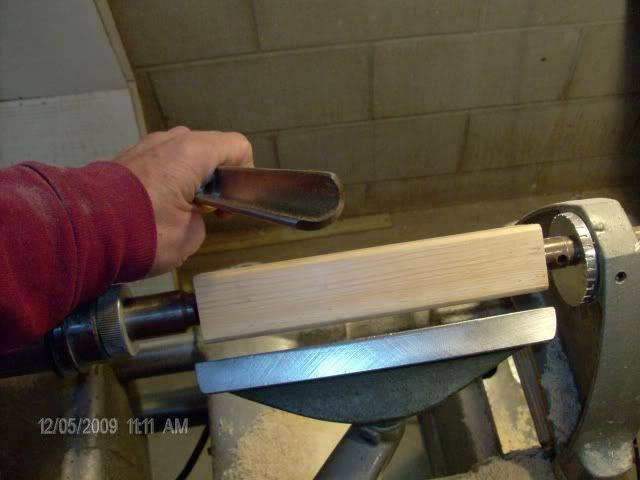

Here is my second attempt, and this time I have before and after pictures.

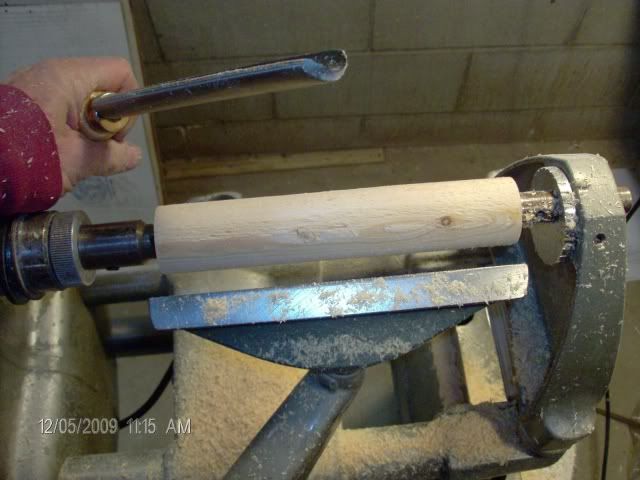

After rounding it off with the gouge.

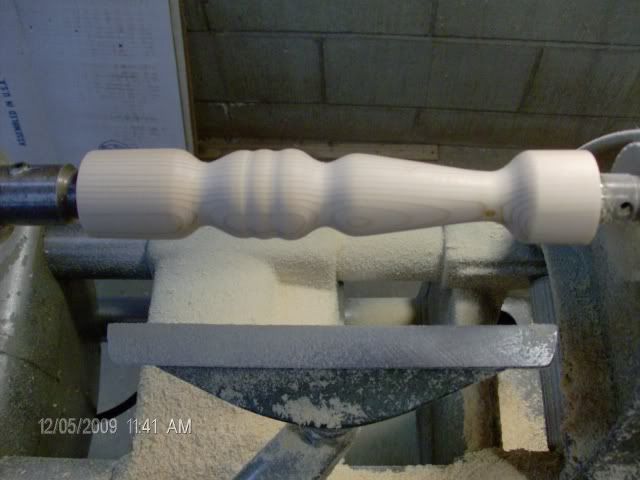

The final turning -- after sanding.
I ended up with a small knot in the thinnest part of the turning. I think that is something to avoid in the future.

Jerry,
Great turning. I don't believe my tenth try was that nice. The knot you mentioned is an issue I have had a lot of fun with. Anytime I find an imperfection in the wood while turning I use a mixture of the shavings from the turning and a light CA glue to file the affected area and then turn the spot again. I have been pleasantly surprised how many times I have managed to save the project. I did discover that if there is soft wood in the blemish area I am best to use a pick to remove it prior to filling the spot. If painting those spots disappear all together. If staining they create beautiful character that draws attention to my work. I turned several Cherry bats for fishing buddies. Two of which had such spots. As the guys and Gals were comparing their bats the two with filled blemishes were by far the favored units. Actually I saved one of them for myself. Jim

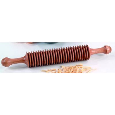

Post by billmeyer »
Great thread!
My wife wants me to make some of these:
[ATTACH]6856[/ATTACH]
This will be my first attempt at turning. My ER didn't have the center and I bought one on e-bay recently. I hope it is not too complicated. I will try some test pieces soon. It looks like fun.
