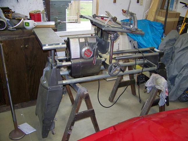

Well I wanted to post again to share where we are at in the rebuild of the 510 to date.
This is what we started with:

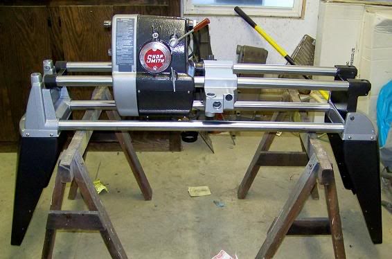

Here is where we are at as of this morning:
I am in process of doing the casters. I received the new wheels yesterday from Grizzly, and have primed and am currently painting the caster parts. Should reassemble Casters by Saturday. Also the mechanicals are back in the carriage, and the table is disassembled.

Very nice progress and a great looking machine.
You'll be making sawdust in no time!!!

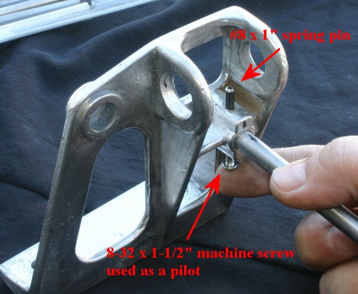

Since you said your doing your casters, I wanted to share this tip in the event that you aren't aware. If your a pro already, bear with my instruction. It will help others. If your not, plan on a struggle getting orientation of stuff figured out unless you have photos to go by or if you marked everything prior to disassembly. It disassembles much easier than reassembles.
The caster reassembly can be (is) a mind game in order to get the cams, lift posts, foot lever, and rods back on in the correct orientation. I just went through it on my ER10 and I am going to post a detailed how to instruction but in case I don't have it posted by the time you do it, here's the most important trick. DRY assemble the entire caster assembly with slip fit machine screws first. The machine screw must be long enough to pass completely (or darn close) though the entire cummulative hole. The screws will ensure that you have everything in the correct place, in the correct orientation, AND also serve as pilot guides as you actually tap the spring pins (or roll pins) in place. This will ensure that you don't break your aluminum castings (as jpg experienced first hand) and is THE MOST important step.
[ATTACH]7073[/ATTACH]

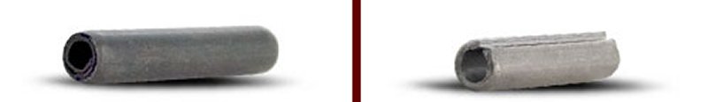

Here's a pic of a roll pin (aka spirol pin) vs. a spring pin. Both serve the same purpose.
[ATTACH]7074[/ATTACH]
Leave the machine screw in place as you start tapping your spring pin in. Keep a finger pressing against the machine screw as the spring pin goes it. Let the spring pin push the machine screw out. This ensures exact alignment.
Good luck. Hopefully, I get my complete caster reassembly thread done by the time you start. It could save you much frustration.

The off center drilling you mention is self detecting / correcting with the 'dry' assembly. There are actually MANY critical steps that I will document in another thread. I just don't have the time to create it right now. I'm getting my reindeer and sled fueled up and ready for my ride tonight.:D
Your suggestion on using the rivet really needs to say "may be a better guide". The cumulative manufacturing tolerances of the spring pin (namely OD, end chamfer), the tolerances of the spring pin through hole OD, and the OD tolerance of the rivet can be such that it will not assure accurate alignment.
The nice thing about using the #8 machine screw is that it either fits real close (closer than a rivet will just by design specs) or there will be a very slight interference fit. If the interference it's too much where gentle hammer taps won't work, a quick, delicate spin of it's OD on a bench grinder will get it just right.
It all comes down to this. As your tapping the spring pin in, you SHOULD NOT CONTINUE if you meet a change in resistance as it passes through the mating parts. If you do, something isn't lining up. You can tell by the sound if your working on a solid surface.
