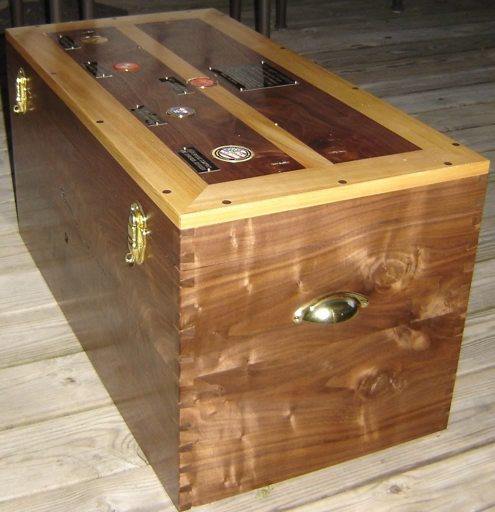

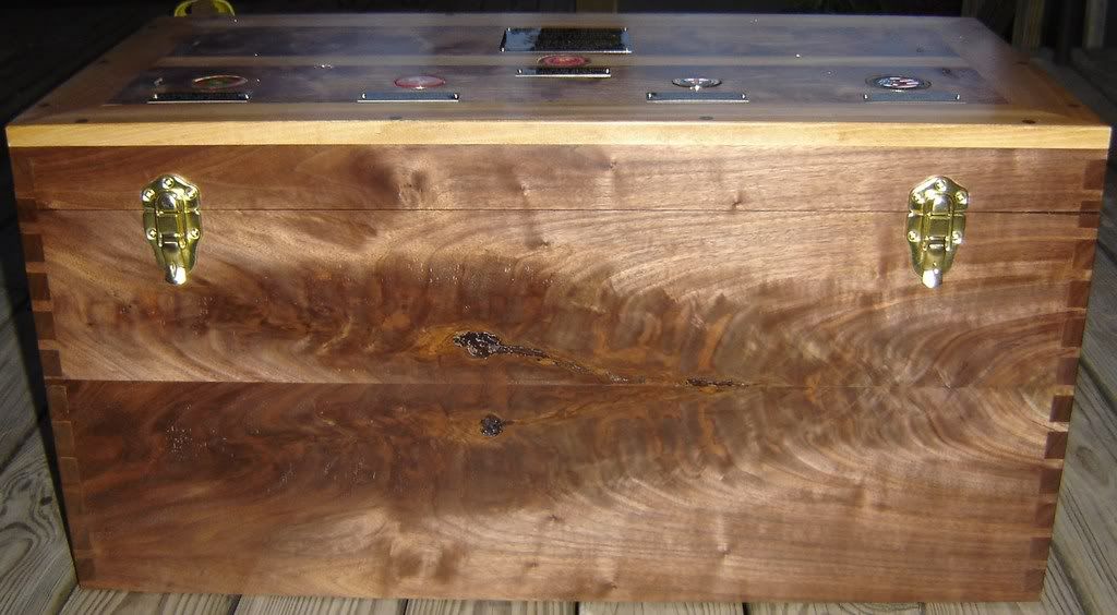

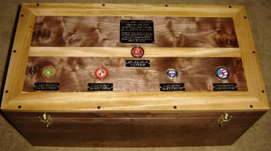

This is a chest I built for a military client. I call it a Campaign Chest and it's loosely based off of one I sw at the museum at the Wilson's Creek Civil War Battlefield. It's made of Walnut and Sycamore. I started off with rough lumber, face jointing, edge jointing, and planing to the approximate thickness I wanted. I then resawed the stock in order to book match the walnut. I wanted a continuous grain all the way around the chest, so I very carefully cut the components (sides, front, back) out of the bookmatched stock. I was able to just barely get all four sides. I used my Leigh jig to mill the dovetails. The lid was made with Sycamore trim around bookmatched walnut. I sawed the lid off on my tablesaw. The walnut plugs in the top were made with a plug cutter and my Goldie SS. I inlaid the challenge coins using several templates, a plunge router, and template guide. It just figures that not one of the coins was the same dimension, so I had a lot of fun using the SS and a circle cutter (MANY times) to get the templates to match the diameter of each coin. The finish is four coats of tung oil (each coat dried one day and was wet sanded with 400g wet/dry paper and mineral spirits). The final coat is a personal blend of tung oil, beeswax from a neighbor's hives, and mineral spirits; buffed out with a lint free cloth. From start to finish, about two weeks' worth of work, with the longest stretch being the finishing process.

Dusty, whenever I did this in the past, I would make an initial cut and put little wedges in the kerf. The was met with mediocre success. This time around, I cut three sides first. Then, for the final cut to release the lid, I double-stick taped 1/4" pieces of scrap hardboard across the opposite side kerf to keep it open so it wouldn't bind on the blade.
"I was curious how did you cut the dovetails? Also what circle cutter are you talking about?"
ScottSS, I used my Leigh D4R 24" dovetail jig to mill the dovetails in the sides. I found it a few years ago in a 2nd hand shop, buried underneath a bunch of junk and covered in dust. Picked it up for a whopping $45.00. The circle cutter is one of those adjustable ones that can cut either circles or wooden wheels on the drill press. Got it at Sears and was one of my very first tool purchases. I love the thing.
Two weeks was one heck of a deadline. Especially when I only had the evenings and two weekends to get it done. The hardest part was the finish, as that took about four days by itself. The bookmatching is definitely one of the advantages of being able to mill my own stock. I've got a great sawyer out here that I've developed a good rapport with. He knows to keep stock for me that's "in the rough" (fresh off his mill), in long lengths, and at least 1 1/4" thick, preferably 2". That way, with resawing, I always have plenty of thickness for jointing and planing. He also keeps slabs and other "throw away" stuff left over from the log milling process. I've gotten some nice live-edge cherry from him for Nakashima-style table tops, etc. As a side note, I very rarely work with standard dimensioned lumber. Again, another advantage to lumber in the rough. Instead of the usual stuff we can get at a Big Box store (3/4", 1/2"), I can easily mill 8/4 stock for large table tops, legs, etc. All this is a result of living in an area where quality hardwoods are often used as firewood!!!

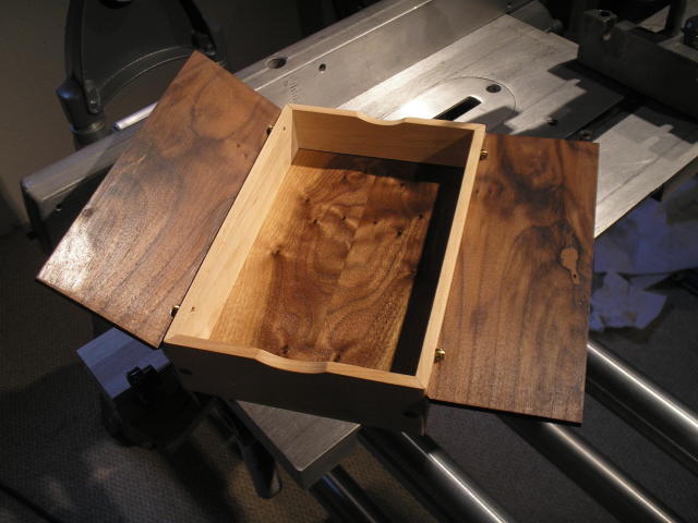

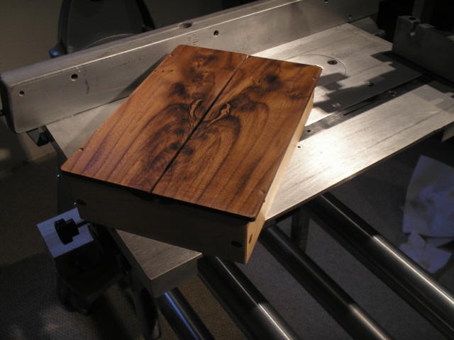

I was thinking of his project when I made a very small box this week, using a couple of similar techniques. This box is meant to hold and honor a book....
