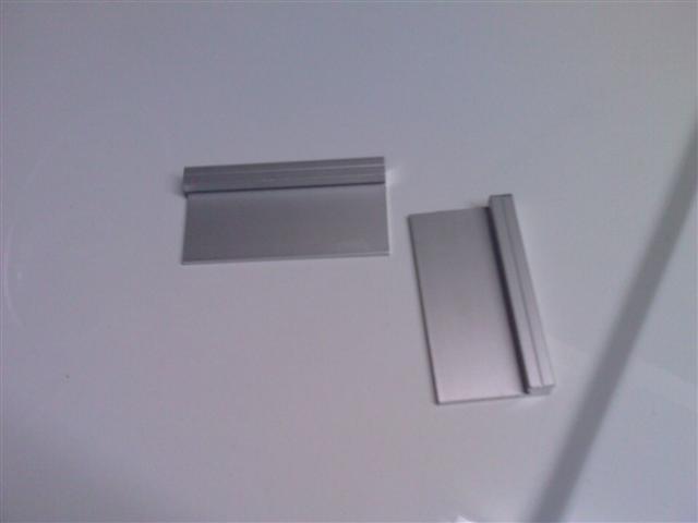

Hi,
I have just upgrade to the 520 Pro Rip Scale (via eBay) and I received a cuple of extra parts that I have over (see attached image) :confused:
Can someone tell me what they are used for (alignment perhaps)?. I see them listed at the SS site http://www.shopsmith.com/ownersite/catalog/RipScaleUpgrade.htm along with a smaller piece (which I dont have) :(
IMAG0147 (Small).jpg (14.48 KiB) Viewed 7462 times

still_waters_43 wrote:Hi,
They are used to set the distance from the top of the table to the top of the rails on a 520.
Jim in Bakersfield:D

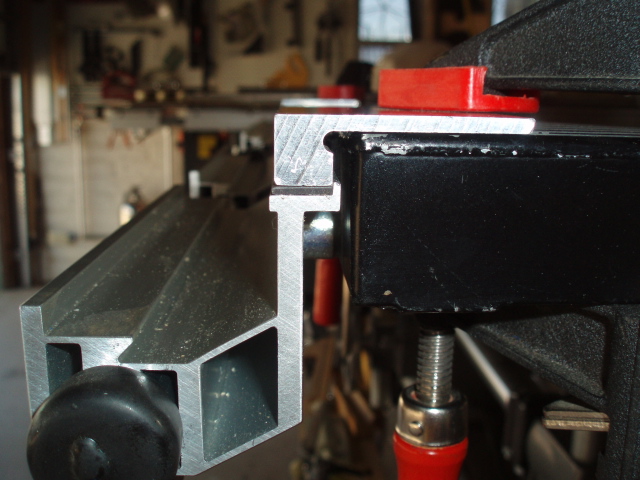

These make short work of aligning your tables. Guard them carefully as the tables require alignment periodically. Jim
F. Jim Parks
Lakewood, Colorado:)
jimthej wrote:They are used to set the distance from the top of the table to the top of the rails on a 520.
If a picture is worth a thousand words, this should explain:
[ATTACH]7539[/ATTACH]
The instruction sheets that came with the upgrade kit instruct one to use them differently than is depicted here but the principle is the same. They are used to set the height of the rail with respect to the table surface.
Incidentally, the actual distance is unimportant. Consistency at all locations, along both the front and rear rails, is what is important.
PA150004 resized.jpg (150.88 KiB) Viewed 7498 times
I suspect that the small part shown on the Shopsmith site that you did not receive might be the fence indicator bar. This is a plastic piece that attaches to the bottom of the fence and helps read fence position on the new scales. I believe the part number is522287.
Rob in San Diego

Thanks all, that helps alot. Also it explains why I had so much trouble getting the floating tables alaigned with the main and extension tables. Tomorrow I'll redo the aligment process withe the tools.
Not sure if I understand where the long scale goes, does it extend from the main accross the floating table/s, if so wouldn't it be hanging in the air (i.e. unless the tables were all pushed together)? :confused:

still_waters_43 wrote:Thanks all, that helps alot. Also it explains why I had so much trouble getting the floating tables alaigned with the main and extension tables. Tomorrow I'll redo the aligment process withe the tools.
Yes, it often hangs over clear air when tables are separated. I now get it set and make a small pencil mark on the rail at the "0" mark to reset it quickly for when I inevitably lay a hand on it.
