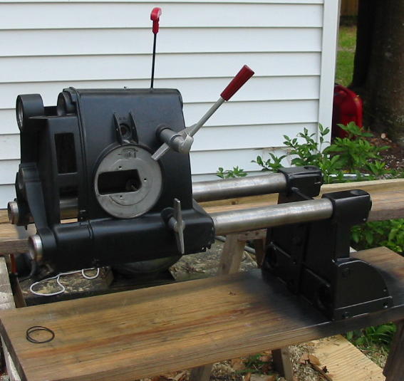

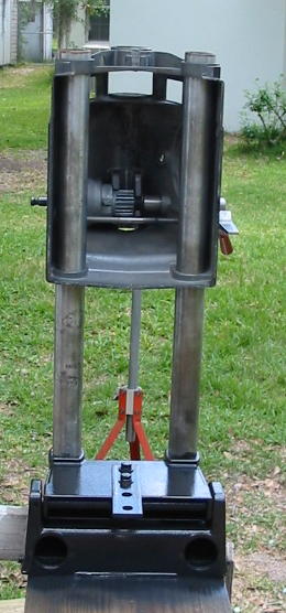

I made the following cradle/stand 7 years ago to hold the Shopsmith headstock. I also use the base arm to hold any SPT to work on and to test with a headstock mounted.
[ATTACH]7905[/ATTACH]
[ATTACH]7906[/ATTACH]

Very ingenious! Thanks for the idea.
