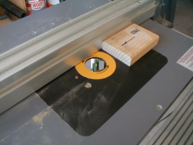

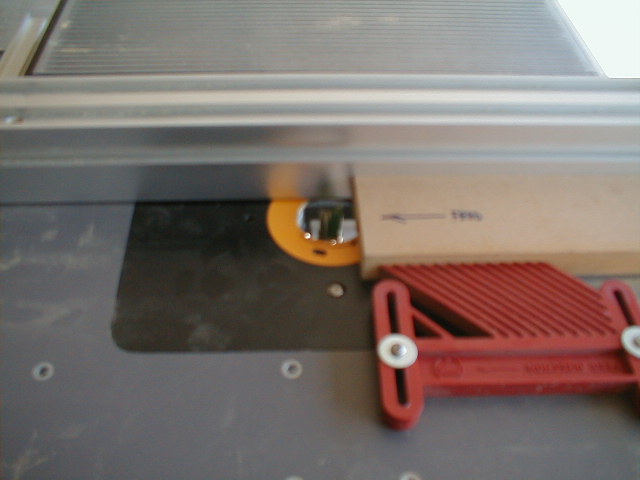

As a temporary test bed, I have turned the router table around by turning the extension table around. This allows me to operate the router off the left end of the Shopsmith and to get a feel for the fence and feather boards.
If this proves satisfactory and SAFE, I will swap the rails.
Please comment on the two photos. Do both represent equally proper router techniques with respect to rotation and direction of feed?
I do realize that use of feather boards is preferred.

Hi,
What you have set up is fine. The feather boards are optional.
The router bit will tend to keep the stock against the fence by the way it cuts. The harder part is making sure it does not rise up and to make sure you never have your hand over the bit. If you happen to have the auxilliary fence (555653) you can attach that to your rip fence and use the feather boards to hold the stock down. (If you don't have the 555653 you can build something like it).
The small piece you have shown should be done with care. First the bit has to much open space around it. Either a smaller plastic insert or the use of brass inserts will fix that. Then you can use the safety kit push stick and push blocks.
I still don't see how you plan to do stock edging, the rip fence is not going to work for that....

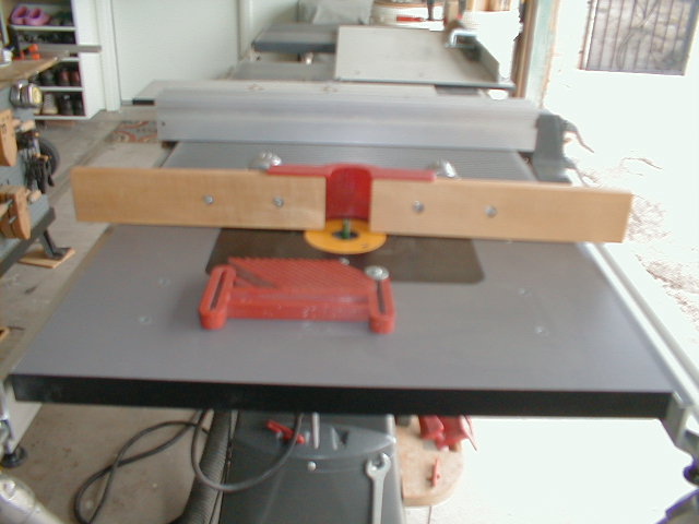

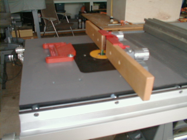

This is my immediate (no further delays permitted) solution to my router table fence requirement. I did change inserts for one with a smaller hole.
I am in the process of developing one with a 7" vertical backboard, dust collector system and sliding fence panels (left/right) to create the split fence.
The hang up is a method of attaching it to the table. I would like to eliminate clamps for this application if I can.
I would sure like to see a Sawdust Session that would cover how SS intended for the table (555995) to be used. I hope their only solution would NOT BE to utilize the Pro Fence (521963).

I see you have an idea of reusing some other hardware for your table. The issue here is going to be how to mount it and let it move inches back and forth... make sure you post some pictures of how you end up solving this.dusty wrote:ed
While some solutions may exist it sure would be nice for Nick or someone to do a video of what they might have as solutions.... I'm sure the intent is to have you buy the additional hardware.
Keep us up to date.
