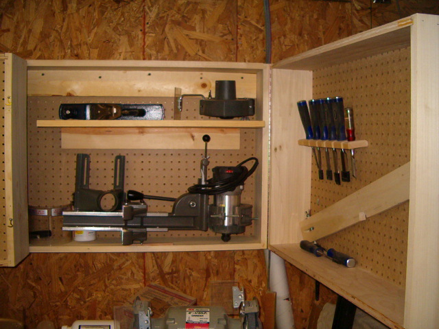

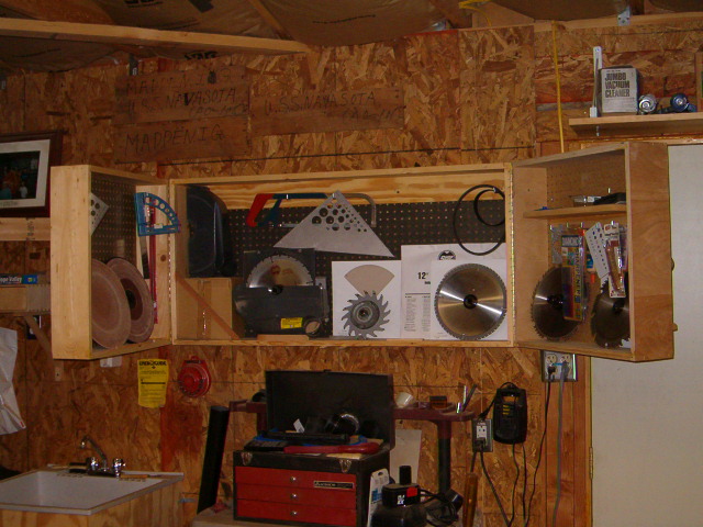

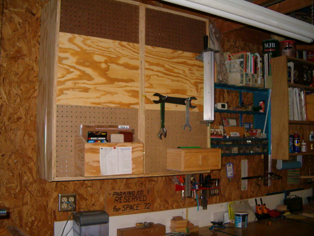

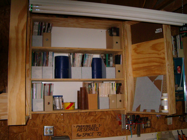

Sorry! I just don't understand why some folks say OSB will not hold a screw without backing. I've had excellent results -
- cabinet_inside.jpg (125.66 KiB) Viewed 6330 times
- Larger cabinet inside half.jpg (128.88 KiB) Viewed 6325 times
- Library cabinet inside.jpg (118.93 KiB) Viewed 6308 times
- Library cabinet outside.jpg (135.4 KiB) Viewed 6316 times

Hi Chuck!charlese wrote:Sorry! I just don't understand why some folks say OSB will not hold a screw without backing. I've had excellent results -
Are you saying that all of those cabinets are ONLY screwed to the OSB, and knot to the framing behind them??? You are a brave man!!!
BTW, I notice that your cabinets are made of ply and KNOT OSB.
Tim
a1gutterman wrote:Hi Chuck!
Are you saying that all of those cabinets are ONLY screwed to the OSB, and knot to the framing behind them??? You are a brave man!!!![]()
Yes, only OSB and they are holding nicely for the last several years.
Cabinets are actually made from left over stock. Some plywood and some solid wood (pine). I wouldn't make a cabinet from OSB, but I would make an "I" beam!
