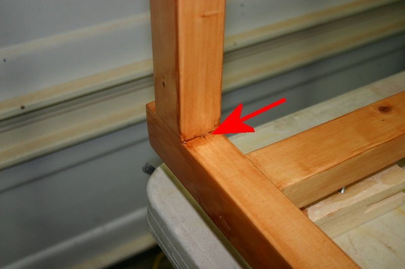

Had I put half the thought and patience into the first coat of the stain / poly combo, I wouldn't have been crying last night on how bad the finish came out. Tonight, I did it right. I applied the second coat this time, using a narrow 1" foam brush, spread the finish real well, and worked around the 4 sides of each component in roughly 10" sections. This allowed for a 'wet edge' as I went along AND it allowed me to see right away if a thicker (darker) area was present which I could easily touch up since it was still wet. Yesterday, I was in too much of a hurry and was anxious to just get done. Final sanding and applying the finish may not be a combo of tasks I want to do the same day. I had the patience for neither, never mind combining them on the same day.
Concluded that the major problem with the combo stain / poly on this type of project is once it starts to dry, it can't be touched again with the brush because it will double up on the color. You can see it here.
[ATTACH]9316[/ATTACH]
When I used it on my front door, it worked well since you start at on end and work your way down to the other. On this project, it is inevitable that your going to come to an area where the finish had been applied 5 minutes earlier and it's tacky enough to 'grab' the stain right off the brush if it touches up against it. To do it all again, I would have used conventional stain, wipe, apply clear finish vs. the combo stain / poly Minwax Polyshade product.

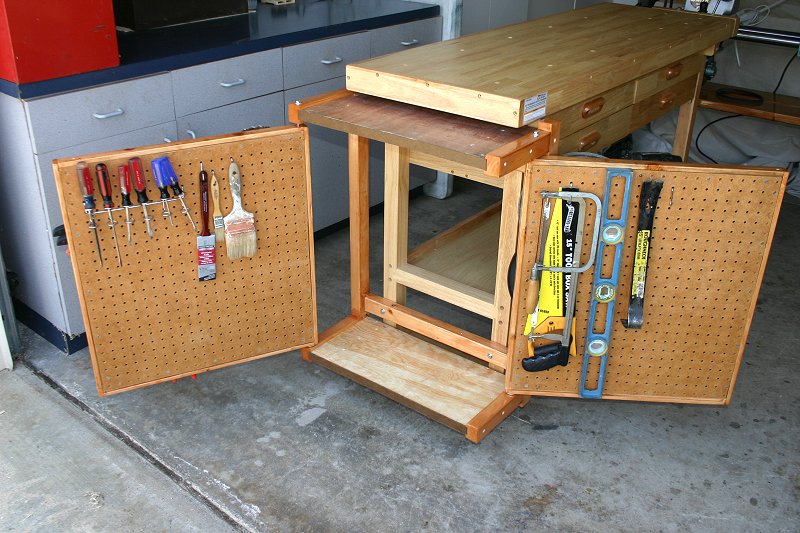

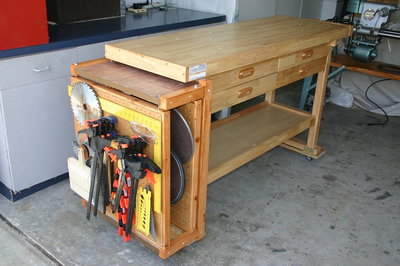

Got the pegboard storage rack completed. Excellent addition to the shop. It gives me 16 sq. ft. of pegboard surface (1/2 of a 4’ x 8’ sheet) and since it is mounted onto the side of my workbench, it effectively takes up no space at all. The pegboard on both sides of the doors is definitely the way to go..

mickyd wrote:Got the pegboard storage rack completed. Excellent addition to the shop. It gives me 16 sq. ft. of pegboard surface (1/2 of a 4’]
[ATTACH]9372[/ATTACH]
[ATTACH]9373[/ATTACH]
[ATTACH]9374[/ATTACH]
Verrry Nice! Now do the 'other end'!:) And the back!:D
You will need the space eventually!

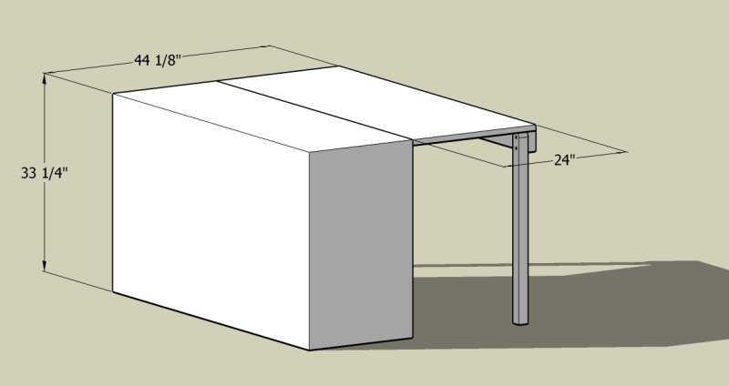

The back of the workbench is reserved for a 2 foot plywood 'drop leaf' style extension with fold up legs. I plan on making that up soon. The right side has my vise on it so I probably need to leave it as is.JPG40504 wrote:Verrry Nice! Now do the 'other end'!:) And the back!:D
[ATTACH]9377[/ATTACH]
- Workbench with 2 foot extesnionmod.jpg (21.15 KiB) Viewed 4175 times

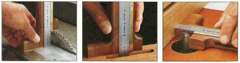

Adjustable Set Up Gage
Next project will be this adjustable set-up gage. The design comes from a '90's ShopNotes magazine #5.
I've used a steel scale quite a bit so far so this seems to be the next logical evolution for it to make it easier to read. I am going to make it out of left over African Mahogany and brass that I left over from the candle lantern project. (7-04-10 update - oops....just came to my senses and realized candle lantern used copper, not brass!! I'll have to go out and buy the brass). The scale is held in place with a rare earth magnet. This allows it to be raised and lowered as needed, as shown in the middle photo.
Easy, FREE project.
