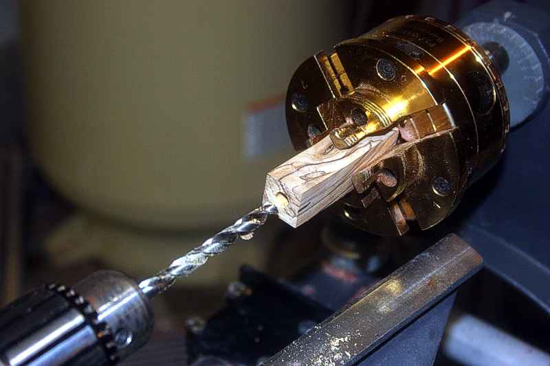

Keith, I do something very similar to drill pen blanks. Check out the attached photo. What you'll need is a ShopSmith Tailstock Chuck Arbor 55603and a threaded adaptor for your chuck. I got mine at Penn State # L5818
- Step 03.jpg (49.24 KiB) Viewed 2746 times
