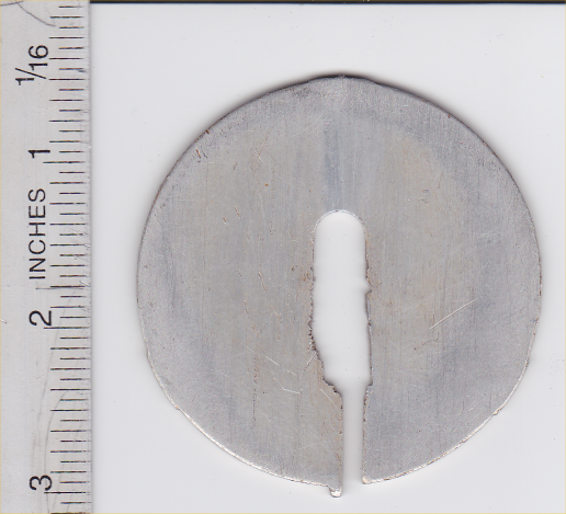

I have an old bandsaw with the old cast iron table and had to order the insert for it as well. If you have the old cast iron table the insert is 2.5 inches and has no clips or screws in it. It has some very subtle "tabs" around the edge of it. It takes some gentle pressure from a screw driver to get it worked into the hole, but once its in, it is held in by mostly friction but holds as solid as a rock. Personally, if you're not gonna replace the table, just spend the money and buy the insert from shopsmith. If you fabricate your own, the fit will probably suck and it will rattle around and frustrate you to no end. Just my opinion.

Photos of the original style replacement parts are always helpful, in comparison to the exploded view drawing on the website.
Mine is kind of beat up, but a scan is attached.
EDIT: Nevermind. I just remembered you said your table was aluminum. The image I attached is of the insert for the cast iron table. But I'm leaving the image attached in case somebody else ever needs it.
