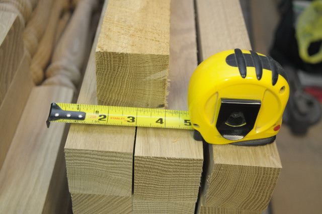

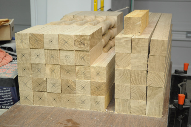

Hi William,
1" oak is easily within the capabilities of the Shopsmith 520. I was asked to do a spindle duplication job this summer from white oak. I was given 2.5" square rough blanks, and asked to produce 2.25" square finished turnings. After I jointed two sides, I ripped the other two to size. I then crosscut to length.
I used a freud Thin Kerf Rip blade and a freud Thin Kerf Crosscut blade. I had little burning and no stalling. My rip fence was set parallel, and the table was set to 90 degrees with my Wixey. I used the Incra miter guage for the crosscut. My cuts were mostly as smooth as the jointer surface.
The Shopsmith has the power.

I assume ya put the duplicator to work! What are they going to be used on(stair rail, balcony, ???).rdubbs wrote:Hi William,
[ATTACH]9852[/ATTACH]
[ATTACH]9853[/ATTACH]
That does not look like hobby work! Interesting!
