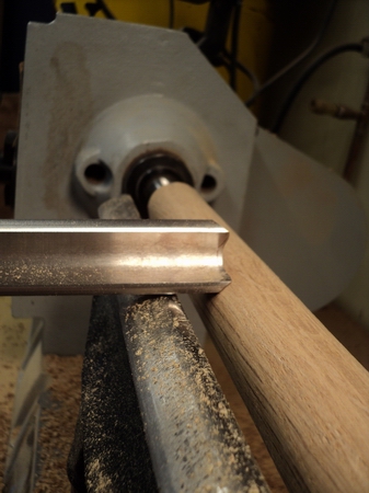

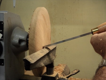

If you are trying to turn a bowl you likely have the grain oriented at 90 deg to the way tubes as in not like a spindle, parallel to the way tubes, yes? If you do and you are trying to "cut" as opposed to "scraping" you will continue to get violent catches as you are orienting the chisel straight into the grain twice every revolution. If this sounds like your problem, try using a scraping tool and keep the handle a little higher than the scraping edge. The difference should be dramatic.
This is "Scraping"
[ATTACH]10619[/ATTACH]
This is "Cutting"
[ATTACH]10620[/ATTACH]
My apologies. These photos are on my Delta lathe but the theory is the same of course.

I think this right. I sounds like the cutting edge of the tool should be a bit below the center line if I understand and that's not what I was doing. The tool in the lower photo looks like a bowl gouge but I can't identify the upper one. Could offer a bit more on the diff between a cutting tool and a scraping tool?
Thank you for your help
--pat
beeg
Posts: 4790
Location: St. Louis,Mo.
Post by beeg »
In the first pic, it looks like a round nose scraper. In the second pic, it looks like a spindle gouge. Remember the "ABC's" of turning. Anchor your tool on the tool rest, ride the Bevel on the work and then Cut.

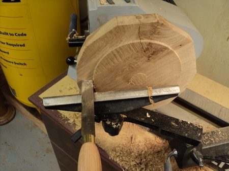

I'll try to explain better. First of all the tool in the top photo is a flat scraper. Here's a better view. I'm working the face here but the rules are the same if I were working the edge.
[ATTACH]10621[/ATTACH]
The tool in the second photo (first post) is a roughing gouge.
The point I am trying to make is that the rules for turning spindles don't apply when you are faceplate turning with the grain of the piece perpendicular to the ways. If you try to "cut" by riding the bevel on the work with the edge shearing cleanly as in the second photo (first post) with a cross grain mounted piece, then twice in each revolution you will be trying to jam the tool straight into end grain. IT WILL CATCH. At the least you will tear out the piece and at worst it can be dangerous. For this type of mounting you should use scrapers (almost square bevel) and scrapers work best with the handle a little above the edge. Not to say you can't scrape with regular gouges in a pinch if you don't have a scraper, the important thing is the angle of attack. When scraping the bevel does not ride.
Try this: Set your piece up on the lathe and orient your chisel to "cut". Turn the piece by hand and observe how the cutting edge will be entering the material as the piece turns. You should see the problem and it should be clear that it can be solved by raising the handle so that the edge isn't aimed into the end grain. This is scraping.
I hope this is clear enough. It's the best I can do.
