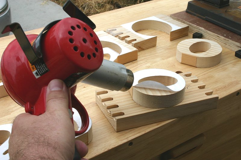

  2. If applying a letter paper pattern to the stock vs. using carbon paper to outline the lettering, use spray adhesive FOLLOWED UP by a layer of clear box tape (aka packing tape). It said the clear packing tape serves two purposes. One, it acts as a blade lubricant AND assists in the removal of the pattern when your done. To remove the paper pattern, use a heat gun and the packing tape shrivels up, in turn pulling the paper and adhesive up off the stock eliminating the need to sand it off. Worked great. The heat gun actually blows the paper/tape right off unassisted. Anyone that glued the paper to the stock without then covering it with the packing tape definately needs to try this method. Makes removal a breeze.

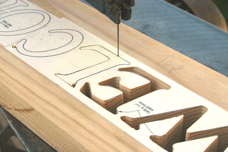

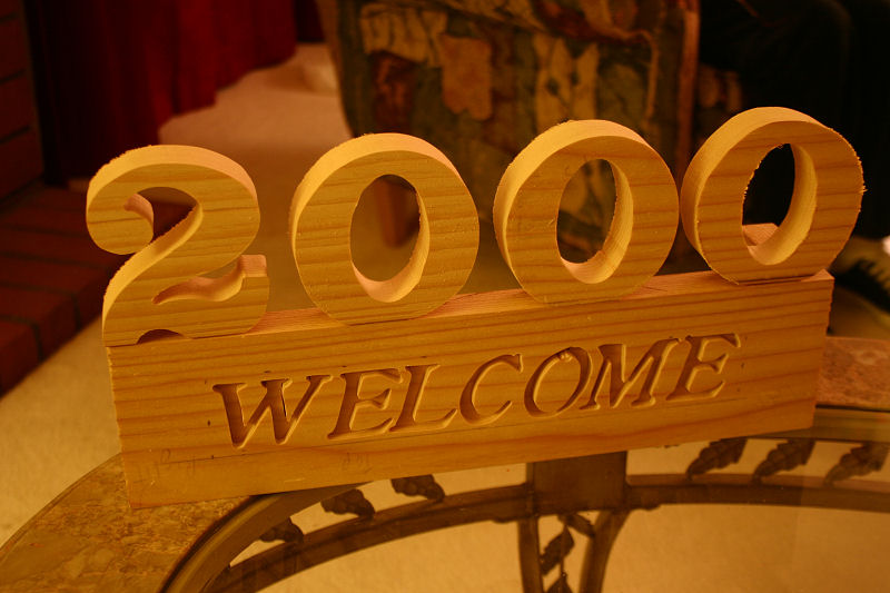

The design calls for scroll saw lettering that gets cut out at a taper angle so that the lettering can be recessed into wood simulating a router cut. To do that, the saw table is tilted about 2-1/2 degrees so that the lettering actually has a small taper. When the blade is removed, the lettering gets pressing into the hole and because of the taper, it stops at about 1/4" deep. Pretty neat effect. This shows the the lettering getting cut out.
[ATTACH]10348[/ATTACH]
Here's what it looks like so far.
[ATTACH]10349[/ATTACH]

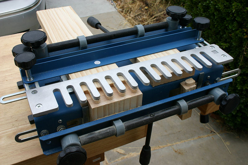

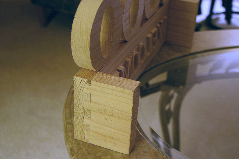

The next shot shows the half blind dovetail joint. This was done in place of the plans butt joint (had to justify why I bought the dovetail jig somehow :p) . Came out pretty decent. The shot also shows the lettering protruding on the back surface that needs to get cut off and sanded down flush.

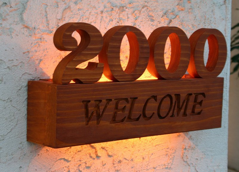

I was going to leave the wood natural color and just apply a clear weatherproof protection coating. My house is a light stucco and the sign just didn't show up very well. It wasn't contrasty enough so I decided to apply a cedar weatherproof wood finish I had left over from a fence project. (Behr premium 501) That added the contrast needed to clearly see the sign during the day.
[ATTACH]10678[/ATTACH]

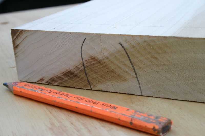

I decided to go with poplar since it's the least expensive hardwood. I liked working with it when I made the furniture legs. Went to the local hardwood lumber yard and saw a piece of 8/4 by 2' length in the 'hobby box'. That's were the dregs (aka cull) goes. Perfect length and thickness for the two stools I plan on making. Plus, it was about 1/2 price!! ($2.50/bf) :D Grabbed that and 2" x 2" x 20' for and legs and stretcher pieces. Total damages.....~$30.

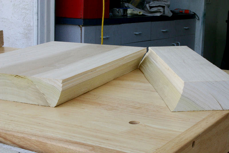

Got the material home and noticed that the 8/4 x 2' had a through crack that went 3/4 of the length. So that's why it was 1/2 price!!
[ATTACH]10714[/ATTACH]
Decided that rather than spending $5 for gas to return it, I'd see if it could be glued once I got the thing halved for the two seats.
This was the heftiest piece of lumber that the Greenie has seen. I was initially going to bandsaw thought it but wanted to see what the 3/4 HP motor could do. Went through it like butter.
[ATTACH]10715[/ATTACH]

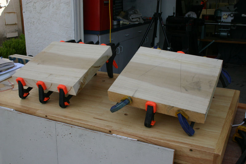

Once it was cut in half, a mallet hit on the face easily split it along the crack. The two surfaces were nice and clean so I felt comfortable gluing them.
[ATTACH]10716[/ATTACH]
[ATTACH]10717[/ATTACH]
So that's where I ended. I'll take the clamps off tomorrow. They'll be ready for turning on the lathe.
