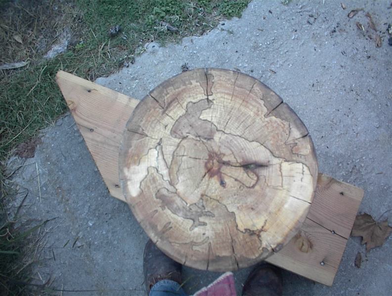

With the logs standing on the floor, there was a tendency for the sanding disc to grab the log and the last thing I need is a 50-60 pound log bouncing around my shop (or on me).
This was a simple jig, the arc matches the diameter of the sanding disk and is at a height to put the log even with the disk. All of these are under 12" diameter. Still, they are crooked enough that I'm picking up the back end and nudging it against the sanding disk to get what I want. It's just gonna take a while.

So is your plan to first use the router jig to get it parallel with the other end and then sand smooth?
Sounds like your moving your log vs. the quill?

mickyd wrote:So is your plan to first use the router jig to get it parallel with the other end and then sand smooth?(/QUOTE]
Router jig wasn't a bad idea, but I burned out a router on it (probably taking too deep a cut) and it looked like I needed to build a better one than my first attempt to get the control I needed. So basically I built a bucking sawhorse and use the chainsaw and a sharp eye to get close enough. Then I can gently use the electric planer to clean that up, then it's on to the SS for a decent finish. I hope to have at least some of these done tomorrow and I'll post a pic.
mickyd wrote:Sounds like your moving your log vs. the quill?
Yep, more control over the log's position that way. Although if the log was square to the disk, I could use the quill, and do use it to rough sand to flat.

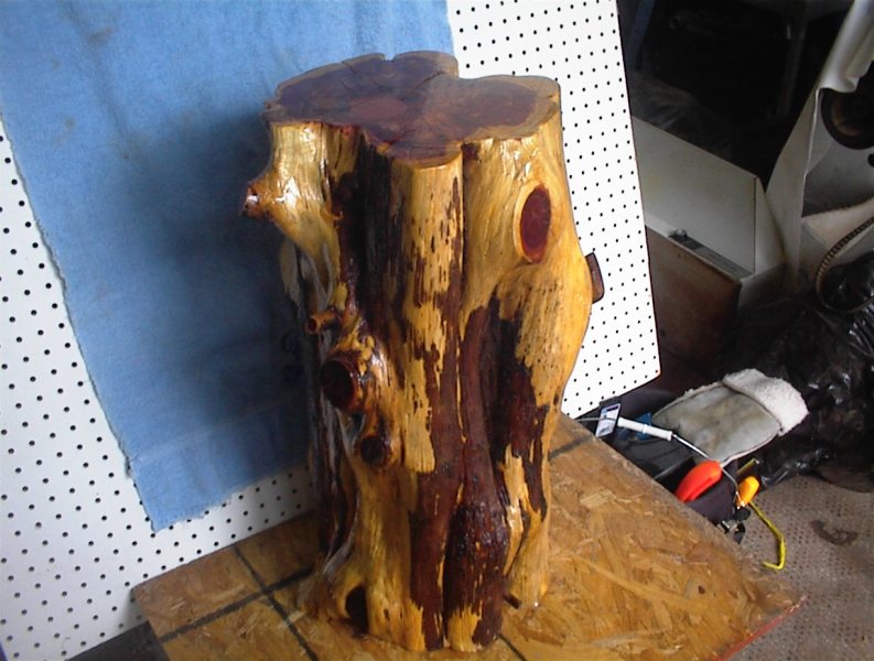

An update on this project. Basically I'm finished and ready to deliver (and get my money).

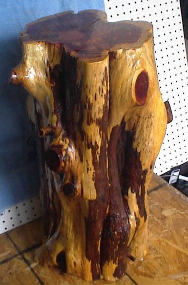

The top of one log stool before...
[ATTACH]10919[/ATTACH]
and after ...
[ATTACH]10920[/ATTACH]
(pictures aren't great but it isn't a great camera)

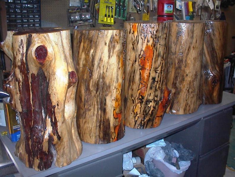

Pictures of finished logs....

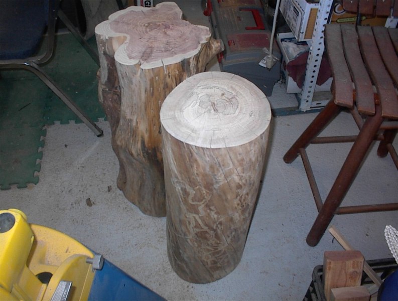

before ...
[ATTACH]10923[/ATTACH]

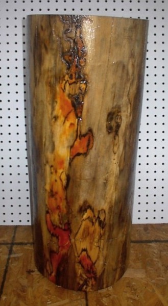

after ... (the glare is the gloss poly finish)
[ATTACH]10922[/ATTACH] the orange staining is natural
[ATTACH]10927[/ATTACH]
[ATTACH]10926[/ATTACH]
all five on bench ...
[ATTACH]10925[/ATTACH]

What was your final method used to get the end smooth? Was it purely sanding with the part on the jig as you described a few posts back?

After sawing the two ends square to one another and close to a final height, I used the simple jig to finish the ends on my SS using the disk sander. It was still not easy because the logs did not lay parallel to the tubes. I actually ended up lifting the "back end" of the log to get what I wanted against the disk. This wasn't all bad because it let me control the pressure, but the darned logs were kinda heavy (still wet wood).
The sides were debarked by hand followed up with a wire wheel on a VSR 3/8" drill.
The finish is brushed on polyurethane.
