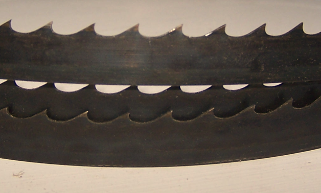

I received this blade with a Bandsaw purchase I made. The teeth(?) are slanted to the RIGHT ?.... all my other blades the teeth are slanted to the LEFT!.
Can someone tell me the purpose for this blade?

Turn the blade inside out.still_waters_43 wrote:I received this blade with a Bandsaw purchase I made. The teeth(?) are slanted to the RIGHT ?.... all my other blades the teeth are slanted to the LEFT!.
How wide is the blade? It looks like a resaw blade.
I think beeg is correct. It is a resaw blade. When you mount it, just make sure that the teeth (on the cutting side of the wheel) are pointing down.still_waters_43 wrote:I received this blade with a Bandsaw purchase I made. The teeth(?) are slanted to the RIGHT ?.... all my other blades the teeth are slanted to the LEFT!.
If it Is turned inside out, it cannot!:eek:dusty wrote:I think beeg is correct. It is a resaw blade. When you mount it, just make sure that the teeth (on the cutting side of the wheel) are pointing down.

Geez! All this time I thought the tooth orientation was the 'puzzle' as well.still_waters_43 wrote:Sorry, I neglected to say it is a 1/2" 3TPI blade.
Methinks ya gots both answers!:)

Go with the PowerPro. You always need a good backup plan. What if you forget this info next week and the forum goes away.still_waters_43 wrote:OMG! turn it inside out! too funny......... I guess that beats my plan B though: to flip the bandsaw, and buy a Powerpro so I could run it in reverse!
