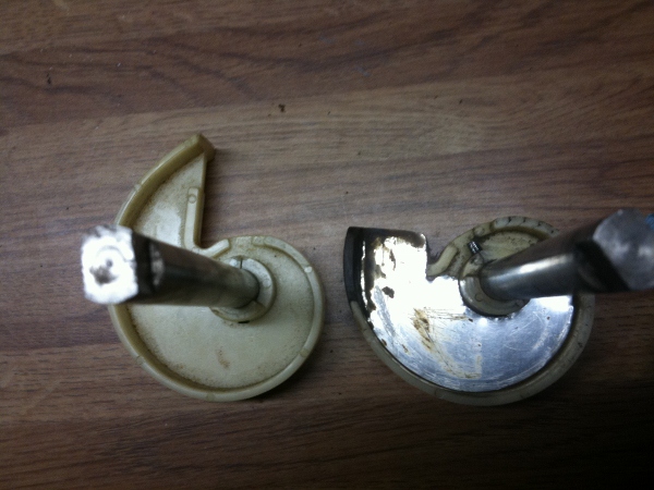

Hey all on a recent purchase for parts Mark VII I came across a Somewhat repair job on a control cam and just had to share it.
It looks as if the guy put some thin aluminum on the inside then built a end from bondo or a rosin type compound although he didnt make it complete as you can see......
I guess you would not be able to get either the low speeds or the higher speed as you cant go all the way around with it and when I got it the motor
would run but the dial had been turned to far and walked off...........
A "Somewhat" repaired Control Cam
- IMG_0135 (600x450).jpg (156.45 KiB) Viewed 2030 times
- IMG_0129 (600x450).jpg (161.02 KiB) Viewed 2014 times
Does anyone know what type of plastic the cam is made of?

damagi wrote:Does anyone know what type of plastic the cam is made of?
"Not heat resistant enough".
I believe it was generally referred to as "nylon". It and the rack on the way-tube both.
Perhaps "Zytel", that miracle unbreakable substance from which Magna American vintage couplers were made of. Too bad they were not 'heat tolerant' as well!:Ddamagi wrote:Does anyone know what type of plastic the cam is made of?
Zytel looks/acts a lot like a more translucent nylon cousin.
