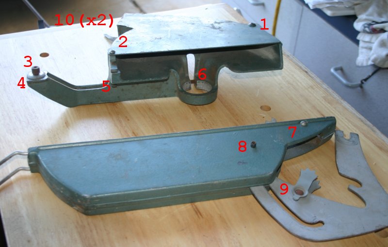

I was interested in starting a thread that shows the different styles upper and lower saw gaurds that went on the older Mark 5's. The style currently shown on the ShopSmith website for the Mark V model 500 tables is much more sophisticated than the older styles.
Here's the one that I picked up with my 2nd used Mark 5, SN 287942, born Dec. '54. The numbers represent the 10 various fasteners it had on it when I got it.
[ATTACH]11053[/ATTACH].
Fastener listing
  1. 5/16-18 x 1/2" Hex Button Socket Cap Screw Alloy
  2. #10 x 1" Slot Round Thread Forming Screw, Type "B" plain steel
  3. 5/16-18 x 5/8" Hex Socket Cap Screw Alloy
  4. 5/16" Finishing Washer Steel Zinc (don't know why it's a finishing washer. Those are usually used with countersunk heads.)
  5. #10 x 1" Hex Socket Cap Screw Alloy
  6. 1/4-20 x 1-1/4" Hex Socket Cap Screw Alloy
  7. #10 x 1-1/4"" Slot Round Thread Forming Screw, Type "B" plain steel
  8. 1/4 x 1-1/4" Spring Pin Alloy
  9. 1/4" x 1/4" semi tubular rivet steel
  10. #10 x 3/16" solid rivet steel (2x) for the bench tube u-brace

Looks the same as this one... (note that these guards are for 9" blades only..)
1st. Generation Goldie saw guard; lower (c.1960)
1st. Generation Goldie saw guard; upper (c.1960)
easterngray wrote:Looks the same as this one... (note that these guards are for 9" blades only..)
So be the greenie(s).Later Goldies also and later gray. (Pre Shopsmith Inc.)
BTW Who Manufactured your 'early' Goldie?

I think it's Yuba... I'll check again this afternoon.
easterngray wrote:I think it's Yuba... I'll check again this afternoon.
Reason I ask, is that I am suspicious the 1 1/8 hp / poly-v version was a Magna-American progeny. The timing is I believe coincident.
BTW the PP Headstock must work really well with 9" blades!
