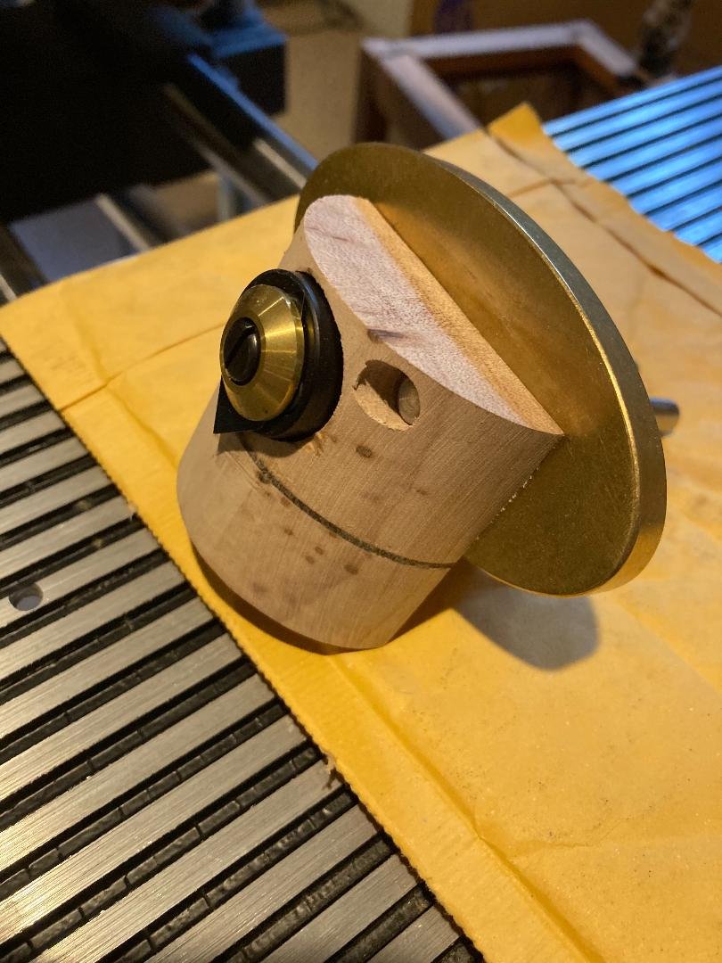

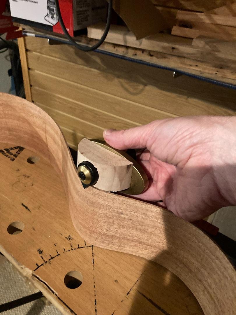

I've decided I'll probably need something similar for an upcoming guitar build. But the guitar (as compared to a violin) won't need to veer as fast, and therefore the cutter can have a larger-radius 'fence'.
I have a very nice Cutting Gage that came as part of a Lee Valley / Veritas string-inlay kit. It has worked wonders for me, and it's heavy. I just fabricated an add-on radiused fence, from hard maple. Some time from now, I'll see how it works :) I may not use it as a full cutting implement, but at least I can use it as a line-striker to protect the wood from tear-out if I used a power router.
Tangent Tool.jpg (137.04 KiB) Viewed 1991 times
Cutting to Purfling.jpg (120 KiB) Viewed 1991 times
Happy woodworking!

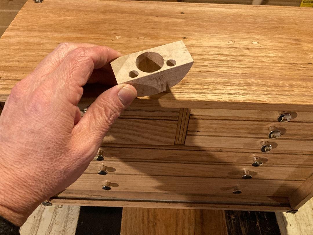

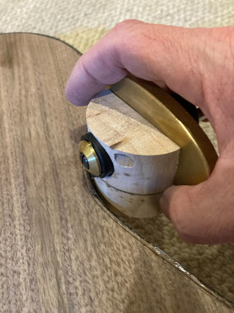

A brief follow-up;
I got around to using this in the guitar resto-mod I've been working on lately. I had to modify my adapter block for greater depth and smaller radius. It does work now!
Purfling Cutter Mk2.jpg (131.53 KiB) Viewed 1566 times
Purfling Concave Cut.jpg (123.87 KiB) Viewed 1566 times
Chris
