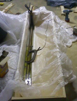

Sorry about the bad quality. It was taken with my phone because I can't find my camera.
It only seems to be removing the rust on part of it. I just started it like 20 minutes ago. Is this normal or will it cover the whole thing eventually?

ogue3595 wrote:Sorry about the bad quality. It was taken with my phone because I can't find my camera.

Cannot tell from your pix, but where is the sacrificial anode?
Realize the reaction is 'line of sight'. That is between the space separating the anode(+) and cathode(-).
You should have the anode(+) lining the entire length of the 'box'.
Might want to rotate the tube as you go!ogwe3595 wrote:Yeah I have a 2'' wide piece of steel running the entire length of the tube. It's working now. I just wanted to make sure I was doing it right so I didn't have to wait 24 hours to find out that it didn't work. Thanks.
