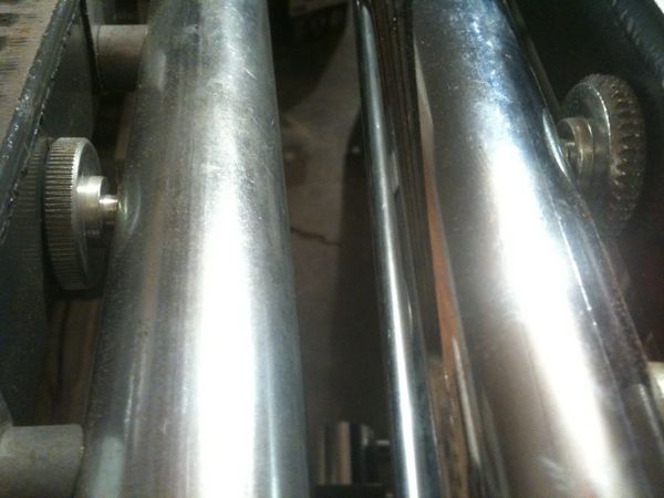

First off, the thumbscrews are slightly different. Also, I'm not sure if the tubes are different metal, different treatments, or just a different age.
[ATTACH]11715[/ATTACH]

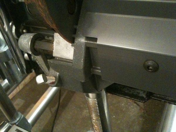

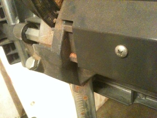

Even more minor, check out the slightly different stop-bolt shapes, and attachment screws:
Table A
[ATTACH]11716[/ATTACH]
Table B
[ATTACH]11717[/ATTACH]
You've probably noticed the biggest visual different by now. The paint on Table A is a close-match grey to most SS stuff, while table B sports a glossier black coat. The black makes Table B look "crisper" in some ways, but I'd actually say the fit and finish is equal, or possibly a tad more ragged on Table B.

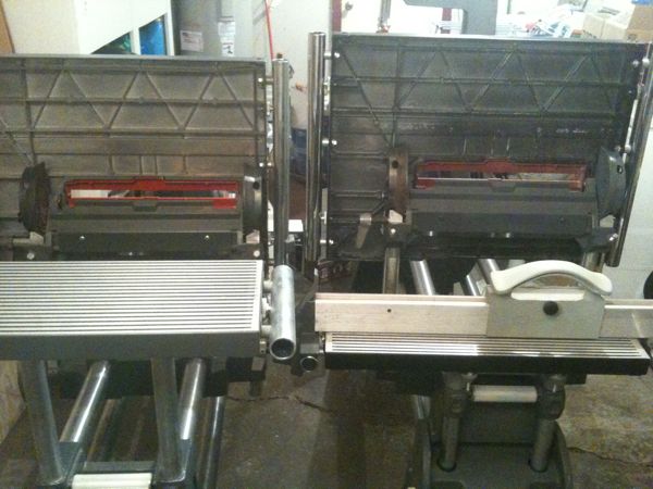

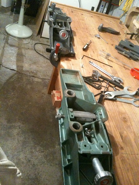

Jointer A is green (and under the Magna label), and Jointer B is grey and made by SS. Both are really quite flat, and both table pairs align very nicely. Adjustment ease seems equal, and I just sharpened Jointer A's blades. From everything I've read, these are nearly identical, regardless of the age difference.
[ATTACH]11730[/ATTACH]
[ATTACH]11731[/ATTACH]
No-brainer comes in to play with these points:
-- Jointer A's xxxxx has a bit of visually apparent wear on the inside of the slotted portion.
-- Jointer A has "straight" down tubes, while Jointer B has the offset ones. Looks like the offset is needed for proper alignment.
So... victory goes to the youngest item... again?
I would keep the offset tubes no matter which jointer I chose.
The cutter head is a very critical item in the jointer. Bearings can be replaced but if the blades don't seat in the cutter head properly, or the shaft is bent that doesn't really matter.
It is my opinion that this decision can not be made without jointing a few feet of lumber and critically analyzing the cut. A slightly bent shaft not only introduces some vibration but it makes alignment nearly impossible.
How do the wedges look.
I suggest you pull all of the blades and all adjustment screws and start from scratch. Time consuming but important.
Wish I had your problem. It has been said that my hobby is maintaining my machines and not woodworking. That just may be (sorta) true. I do spend a lot of money on wood.
