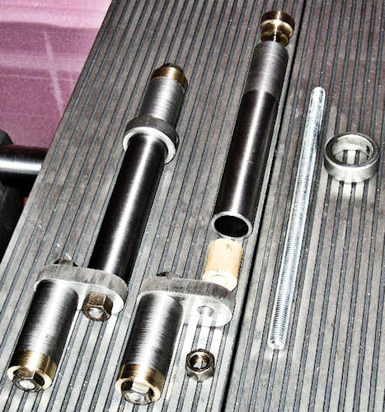

Here is how I made a set of offset tubes for my jigsaw mounting:
[ATTACH]13165[/ATTACH]
You could likely use hardwood or plastic instead of brass and do the turning on a Shopsmith.
jigsaw eccentric tube components (2).jpg (118.84 KiB) Viewed 1003 times
