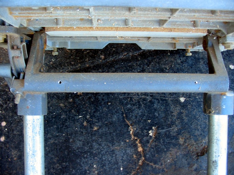

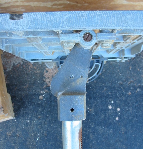

I think I understand but If anyone that has one could take a picture of the mounting area for visual reference I'd really appreciate it.

jcraigie wrote:I think I understand but If anyone that has one could take a picture of the mounting area for visual reference I'd really appreciate it.
Two pictures, the first shows the holesin the tie bar for that portion of the guard:[ATTACH]13272[/ATTACH]
The second shows the holesfor the upper guard:
[ATTACH]13273[/ATTACH]
Hope this helps.

jcraigie
Posts: 505
Joined: Sun Sep 05, 2010 8:17 pm
Location: Fowlerville, Michigan
Post by jcraigie »
Perfect, thanks guys.
