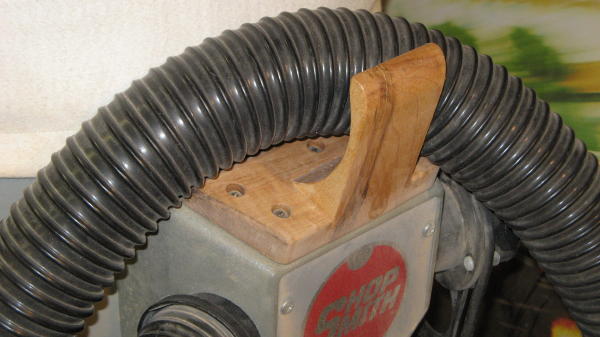

I recently got a DC3300 off of craigslist. It is in decent shape, has the upgraded 24" hood and seems to have a lot of suction power. However, here is my question:
It does not have the handle upgrade on it. How useful is this and will I wish I had it?

If you move it about the shop a handle is nice but if it sits in the corner and you don't move it - you don't need the handle. I move mine so I decided to make a handle, a fun little project for an evening.
[ATTACH]13340[/ATTACH]
- DC 3300 handle.jpg (43.71 KiB) Viewed 1004 times
