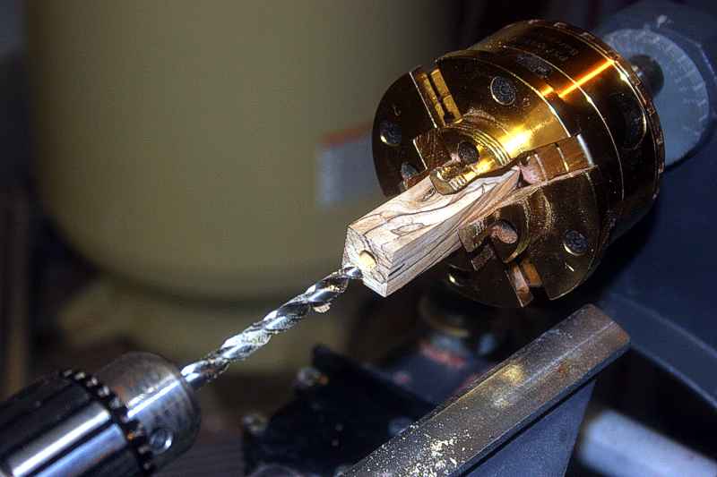

I use a chuck on the SS to drill blanks, but have found that I get better drilling to put the jacobs chuck on the quill and mount the 4-jaw chuck on the tailstock like this.
[ATTACH]13654[/ATTACH]

As always, thanks for the help. I might have the arbor in my "box of misc stuff", if not $20 to Shopsmith seems reasonable. I've had some success with drilling blanks with other methods, but this seemed accomplish the task with the least amount of reconfiguration.
