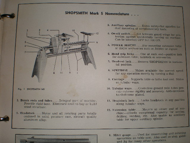

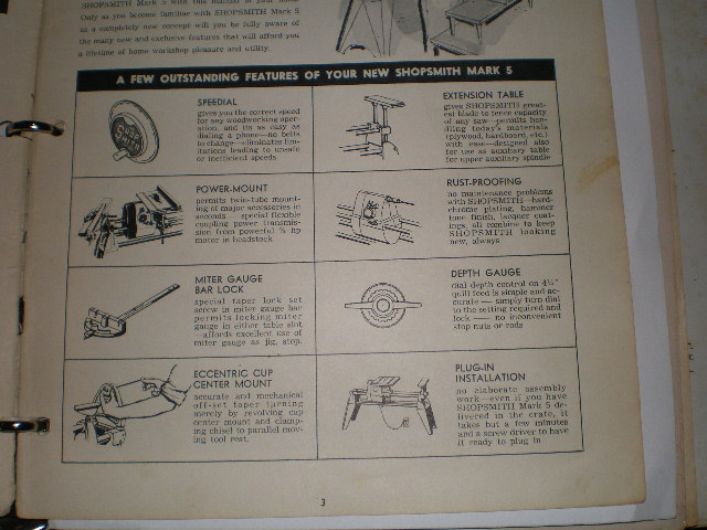

terri's potting bench 002.jpg (132.79 KiB) Viewed 2821 times
terri's potting bench 003.jpg (136.07 KiB) Viewed 2813 times
A quick review of my 1962 manual reveals the same descriptions etc. Hard chrome it is. Not very shiney(ever). Grinding marks still visible after all these decades. Bench tubes painted gray.

I worked in a machine shop in the 70s as an apprentice where we made those tubes.
The finish ( in machine shop vernacular ) is industrial chrome.
Just not as many layers and the polishing under the chrome is not present.
