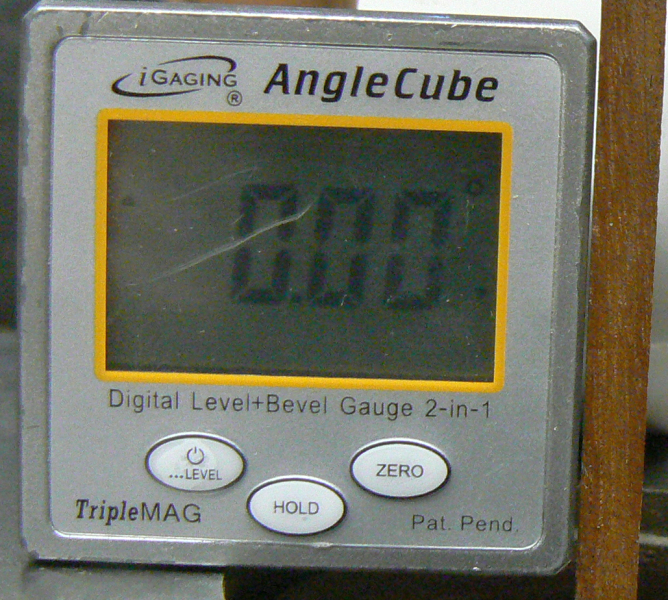

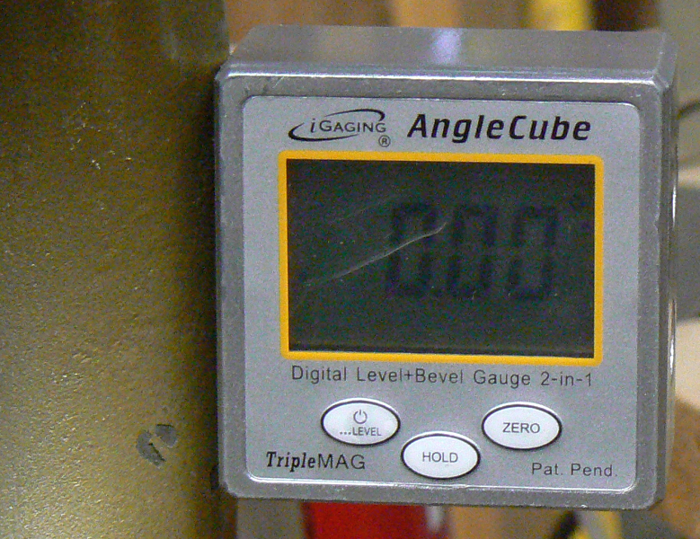

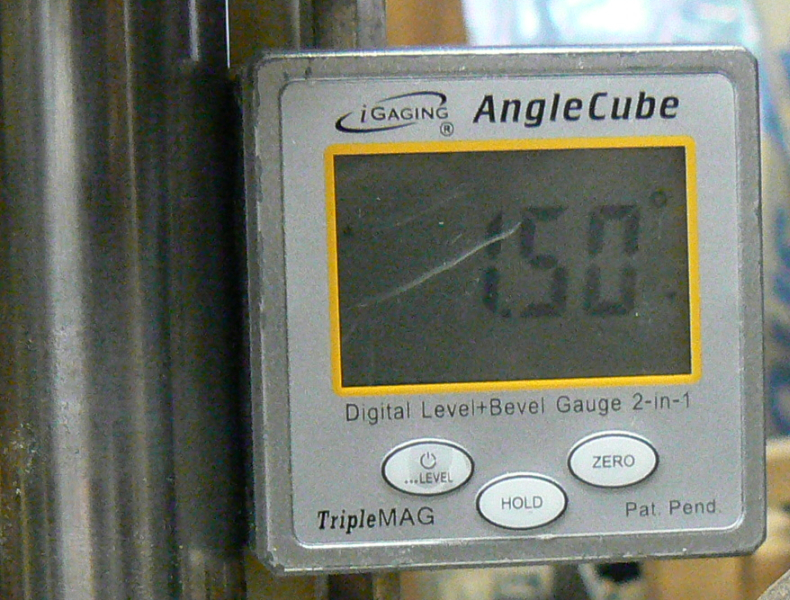

[ATTACH]14337[/ATTACH] Tilt to the left

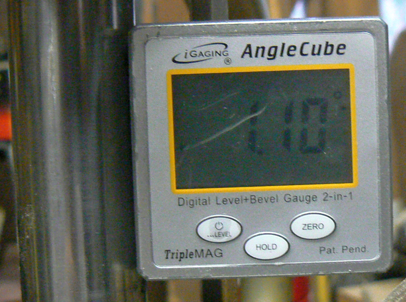

[ATTACH]14338[/ATTACH] Tilt to the right

JPG40504 wrote:Now that Ed has pried open Pandora's box(I always assumed the roll pin and notch 'assured' tube/table alignment). Tain't so!!!!
So how much can it be off?

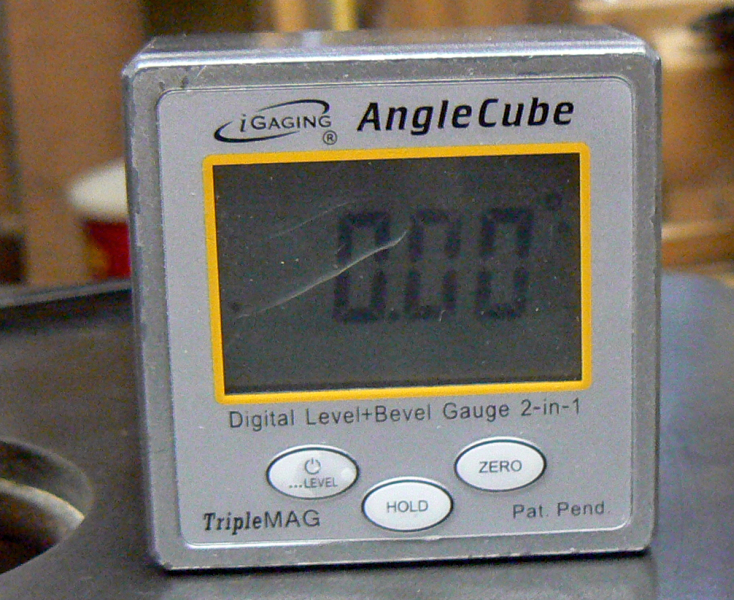

[ATTACH]14341[/ATTACH]
Step one: zero reference the angle gadget to the table left to right. This is not adjustable.(no shimming ]14340[/ATTACH]

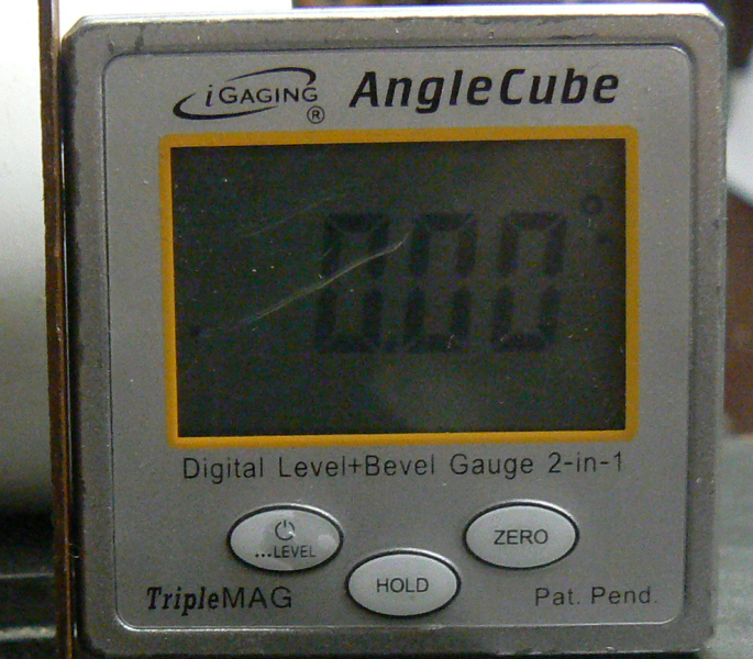

Step three: Verify Blade plumb to table left to right. Actually nothing to 'adjust' here since the 'blade' is inserted into the upper and lower clamps and positioned all the way to the right(all the way to the back of the clamp). This serves as a check on the tube plumb adjustment.
[ATTACH]14342[/ATTACH]
blade plumb l-r.jpg (616.16 KiB) Viewed 1047 times
table zero ref l-r.jpg (639.18 KiB) Viewed 1052 times
