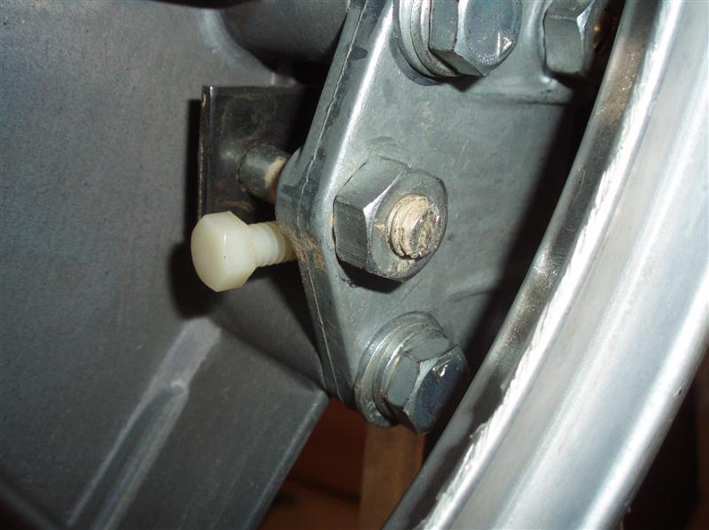

This is not a bearing issue/question but it arose while I was working on the bearings.dusty wrote:I would bet that you have a noisy auto-track bearing]DO NOT OPERATE THE BANDSAW[/color] with the Auto-Track bearing removed. However, you can stop the Auto-Trac from spinning by very carefully reaching in behind the bearing and applying finger pressure to the bearing. If you choose to do this, BE CAREFUL.
Bottom Line: the Shopsmith Bandsaw will never be really quiet. By design, it is rather noisy to operate but it should not squeal, howl or screech.
What is the nylon screw for. I find no reference to this screw in the manual. I have tinkered with it and it seems to effect the Upper Guide Height Lock feature.

I believe this has been discussed before and it was determined it was an adjustment on the upper blade guard to keep if from free falling down and also to steady it.dusty wrote:This is not a bearing issue/question but it arose while I was working on the bearings.
