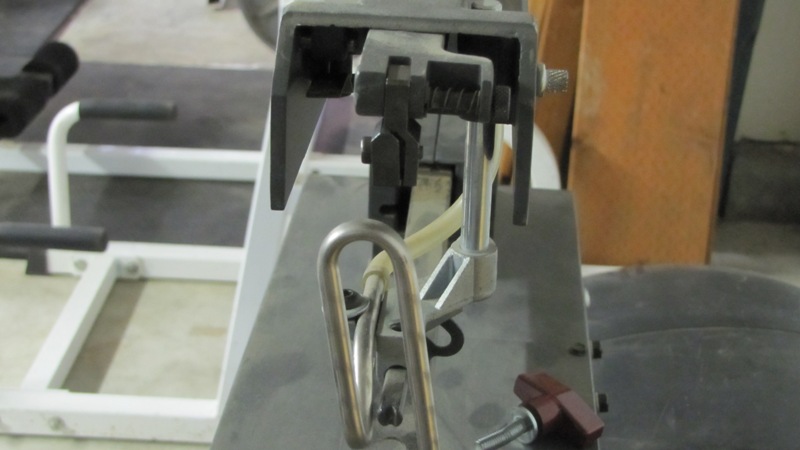

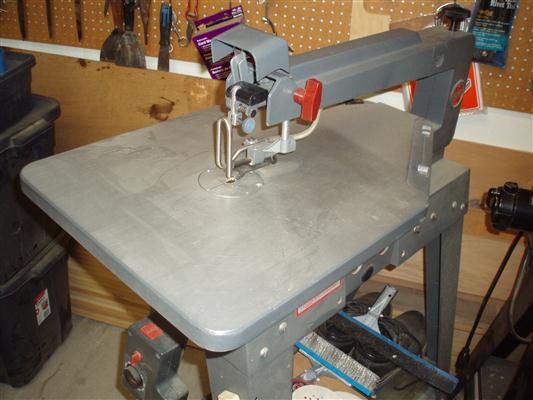

Dusty, yours looks the same as the Master Inside exploded view pic of a Mark V Mount version. I see yours is a stand mount though.
Look at the pic of mine, its different??
[ATTACH]18910[/ATTACH]

mrhart wrote:Dusty, yours looks the same as the Master Inside exploded view pic of a Mark V Mount version. I see yours is a stand mount though.
I believe your is just lacking the blade block upgrade that is in place on Dusty's machine.

mrhart wrote:Thanks for the link. For those of you who have this upgrade, is it a worthy cause?
Absolutely. Be aware, this upgrade only effects blade change; making easier and less time consuming. Everything else is the same.
The cutouts in the table top are no longer needed if you have the upgrade.

Dusty on the back of your last pic (rear cradle) there is a black cyliner for hold down or support maybe. Even with the Master Inside Mark V scroll saw exploded view (page 58) on 400% view, I don't see it. :confused:
