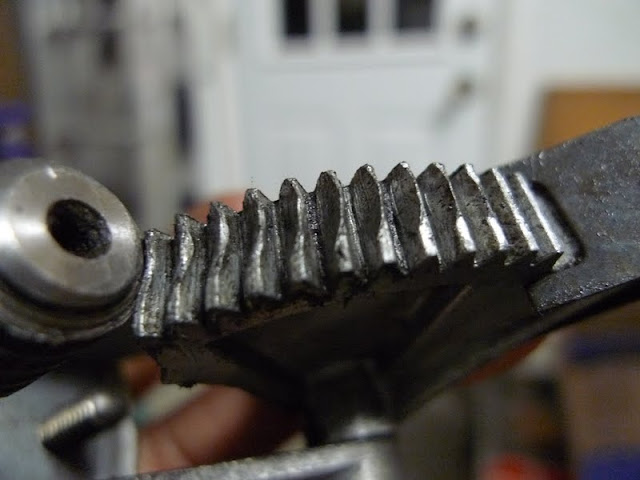

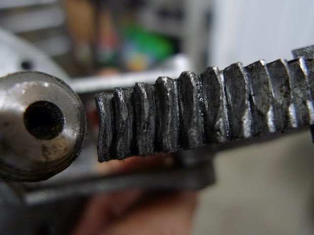

For long term reliability the quadrant needs to be replaced.
However the arm which is now bent that caused the bias in the wear should be 'straightened'. The roll pin should be replaced with a screw ala Bill Mayo.
That 'fix' should be done regardless.
The existing one is 'usable' after the 'fix' is done and may provide years of service.
I would get a 'spare' to have on hand.

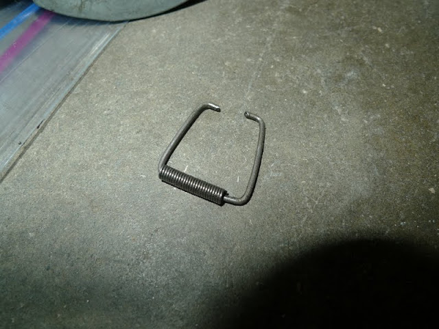

The clip is reusable, but it may need a bit of forming(it is 'out of shape'). I do not know if ss will provide one sans control sheave.
- Posts: 21481
JPG says you can use it after you fix it but I would replace it and then do what can be done to recover the damaged one which I would promptly put away as an "emergency only" spare. A spare which you will probably never need unless you abuse the quadrant like someone else done before.cllib wrote:The Quadrant doesn't look good. Should I fix or replace it?

- Posts: 35457
The 'kicker' is that once the mis-positioned worm gear is put back to where it belongs, the contact line of the two gears is different from the wear surfaces location(along the center of the quadrant gear).
- Posts: 35457
There be a lesson here! Notice the wear is all on the side of the quadrant gear teeth that is pressed against by the worm gear when adjusting from a higher to a lower speed.
This can be prevented by doing so slowly so as to allow the floating sheave time to respond to the control sheave squeezing the belt. Yes squeezing the control sheave into the belt is what slowing down does. The floating sheave restores equilibrium by opening up and allowing the belt to ride up on the idler pulley.

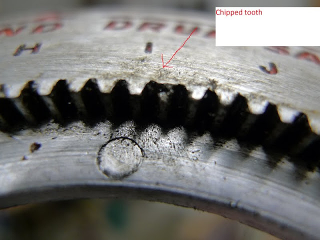

Teeth of the speed control dial
One tooth is chipped. It should be good. Thanks for your information.

I didn't remove the copper clip
I kind of mislead by Nick's Video. I searched the forum and found
http://shopsmith.net/forums/showpost.ht ... ostcount=4
I will try to remove the copper clip later. :-)
