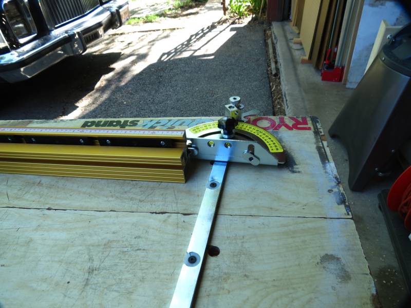

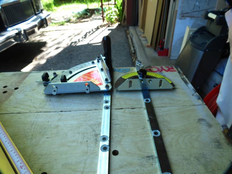

Here is something that I just happened to notice today while I had my two new Incra pieces on the shopsmith at the same time. If I had to title it, "Incra meets Incra" would be my choise.
The Incra I box was just aligned again after taking it apart for pictures, the V120 I just put together yesterday, the shopsmith, well it was just there to provide miter slots.
When I slid the two together what did I find. I found that they align with each other perfectible. And I'm quite sure that is because they are both right on right.

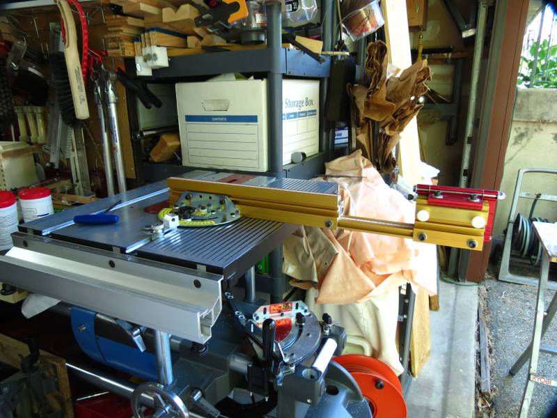

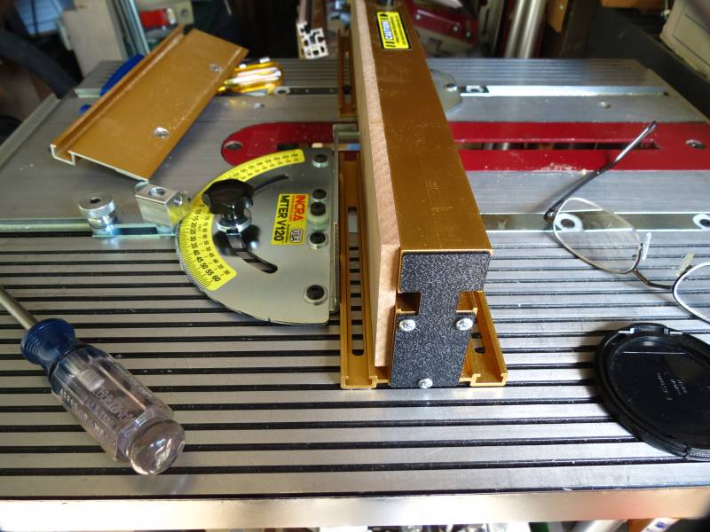

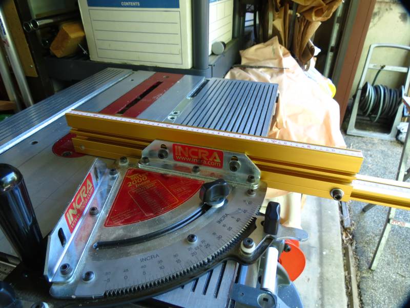

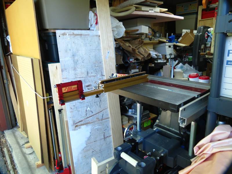

My thoughts have been that when I got a V120 that I could probably use the interchange the fence between the two. So lets get to some pictures to make it clear what I was thinking about. First some shots of the 2000.
[ATTACH]21780[/ATTACH]
[ATTACH]21781[/ATTACH]
[ATTACH]21782[/ATTACH]
Keep in mind that you would want either or both a floating table/fixed table to a real setup, this was done for the photo op.
Now we can look at both miter gauges, will things really fit?
[ATTACH]21783[/ATTACH]
To find out you will have to go to the next post.
So lets get to the photos.
[ATTACH]21784[/ATTACH]
[ATTACH]21785[/ATTACH]
Yes, it works!
