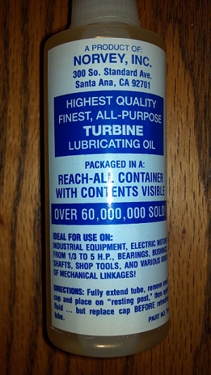

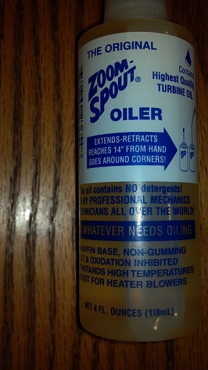

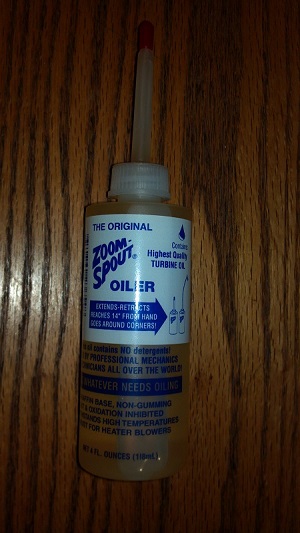

This is what I use. It can be bought at ACE Hardware.
[ATTACH]22145[/ATTACH]
[ATTACH]22146[/ATTACH]
[ATTACH]22147[/ATTACH]
Zoom spout is handy for oiling other things too.

Oil
