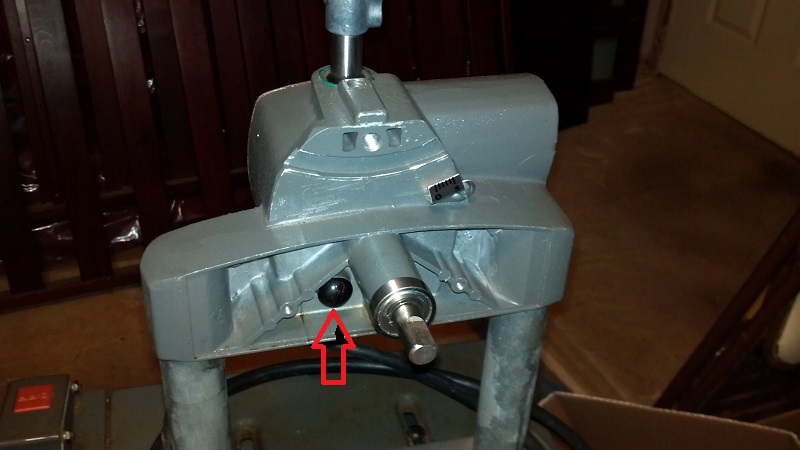

Hello, your jigsaw must be mounted on the MarkV/Pwr Station or at least in an upright position.
Fill and oll level is done at the screw pictured below.
[ATTACH]22122[/ATTACH]

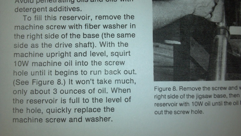

Per the manual.....
[ATTACH]22123[/ATTACH]
Per the manual.....

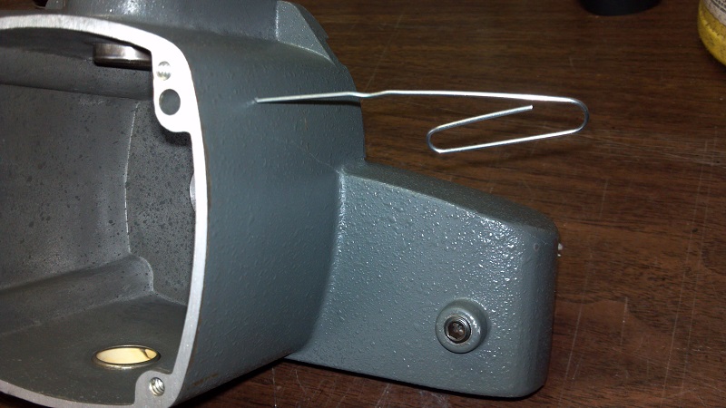

Vent hole....about the size of a paper clip.
[ATTACH]22124[/ATTACH]
