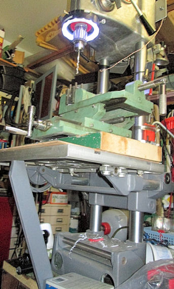

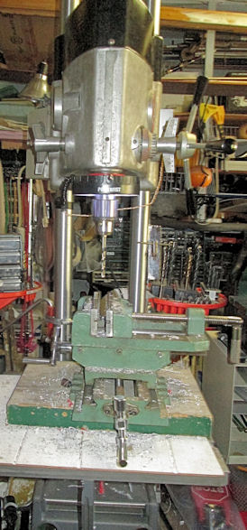

Quote " Why don't you care for it? " Well, my drill press is used a lot for metal work, so I put an x-y vice on it. It had to be elevated a bit to allow the cranks to clear the table. No longer clean.
[ATTACH]22403[/ATTACH]
I braced the table with a short strut:
[ATTACH]22404[/ATTACH]

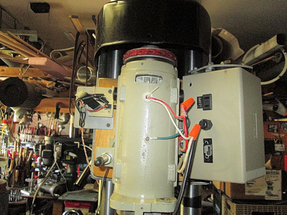

By the way,if you install one of those ring lights, make sure vibration does not cause it to fall onto the rotating chuck, wrapping the cord up and flinging the off/on switch into orbit. DAMHIKT! I fixed it by making a jam fit donut (the red ring) on the quill with three radial holes matching the screws from the ring light and replaced the switch.
The head now has that industrial variable speed sewing machine motor on it. Details:http://www.shopsmith.net/forums/showthr ... ng+machine
[ATTACH]22405[/ATTACH]
